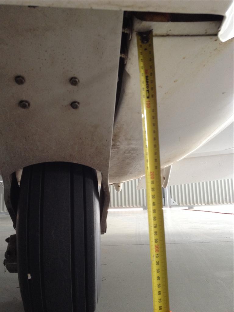

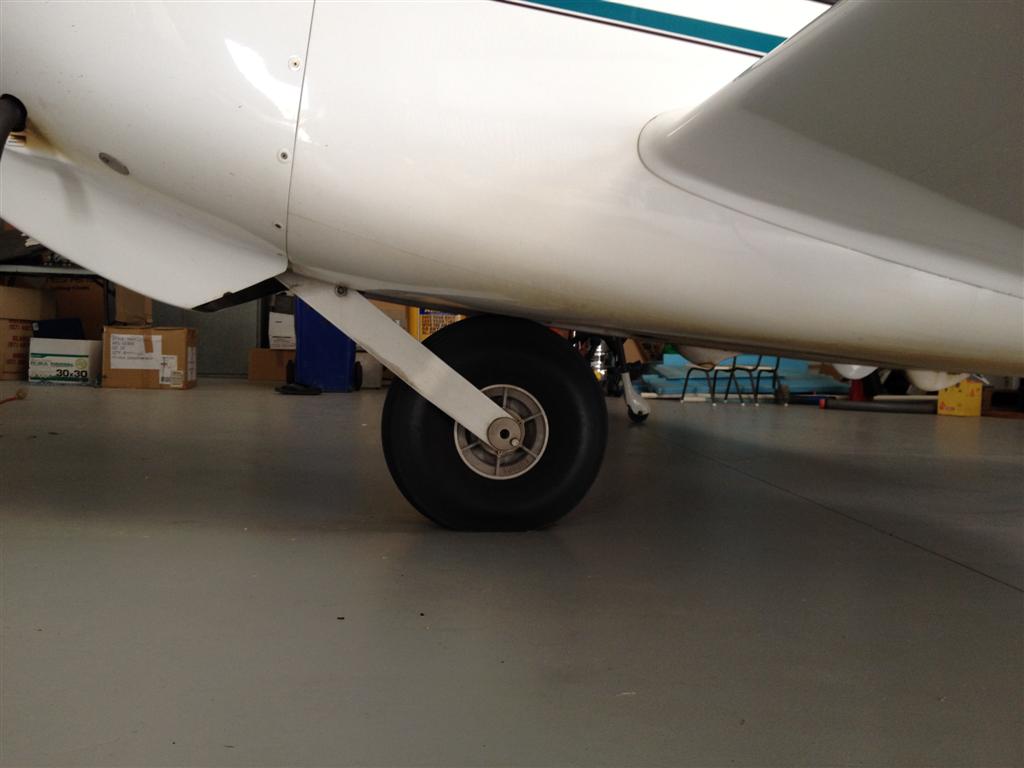

PostPosted: Wed Jan 08, 2014 4:56 pm    Post subject: Mono dolly Reply with quote
Would someone be kind enough to measure the distance between the ground
and the bottom of the fuse at the point where the cowl meets the fuse
(firewall) on a completed mono sitting on the ground.
Ron,
Height on ours is 490mm or 19.3". Tyre is 700 x 6. Photos to clarify
attached.
Kingsley
 Filesize:  69.69 KB
 Viewed:  2540 Time(s)
 Filesize:  56.67 KB

PostPosted: Wed Jan 08, 2014 9:36 pm    Post subject: Re: Mono dolly Reply with quote
Hi Kingsley
Thx. for measuring, it was exactly what I needed.
Since I'm using castering wheels, they should be as close to level when the main is off the ground and I want to go sideways.
Ron Parigoris
