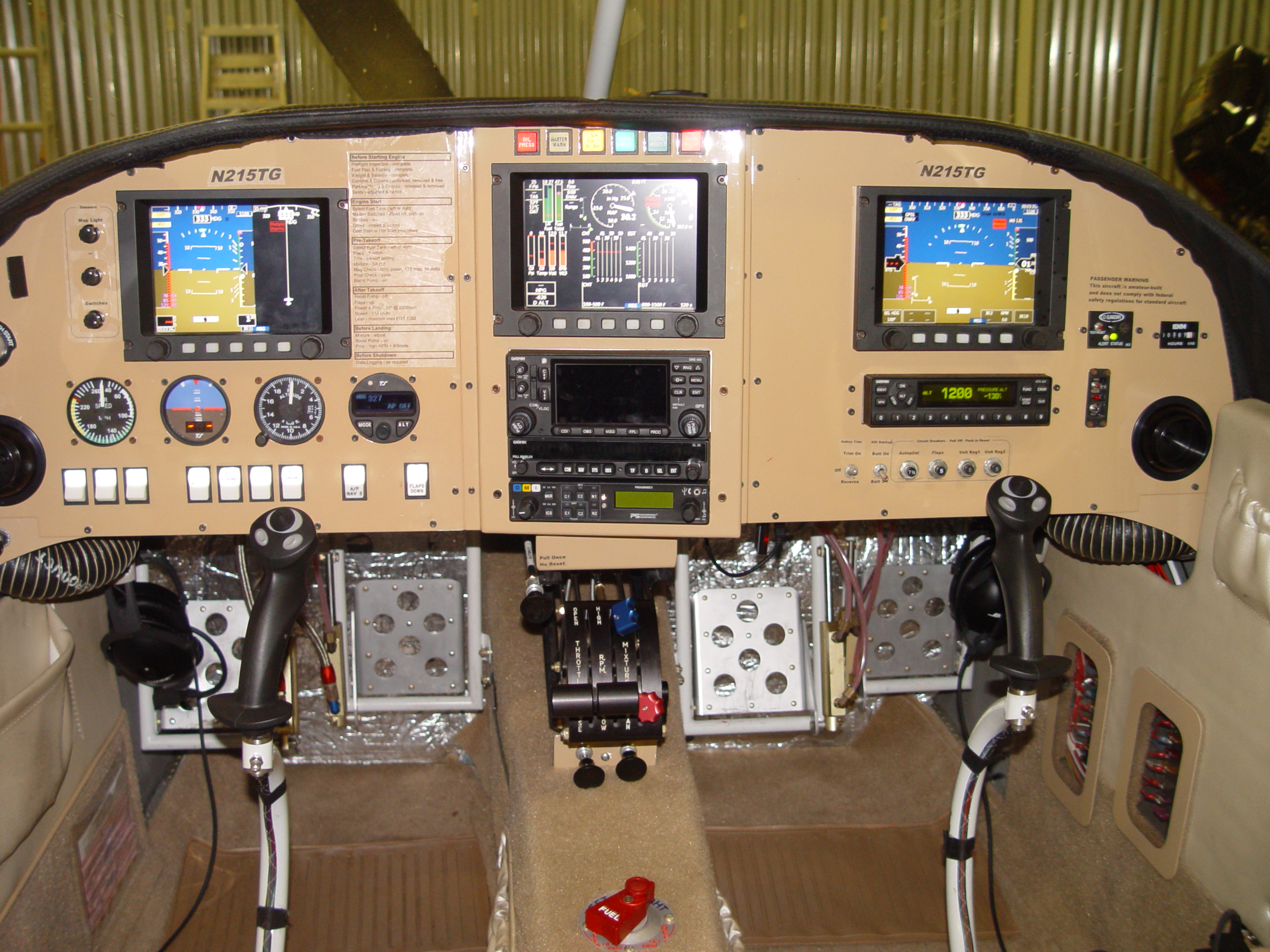

FWIW, I painted my RV10 panel a light brown/tan to match the rest of my interior. It was a high gloss polyurethane. No regrets with the paint, gloss or color after 350 hours. including plenty of IFR work.
My panel is mostly glass panel, lit screens and lit rockers. My eye comfort and performance seems to exclusively be a product of screen quality and and their brightness (especially at night).
I'll attempt to attach a pic of the panel (with plenty of glare from the flash). Assuming the pic comes thru as intended, I'd add that the only regret I have about the panel is placement of the center EFIS screen (they are GRT HXs). I should have put the left and center EFIS close together. The distance between the two screens makes it uncomfortable to use the center EFIS as a moving map. Instead I have to split my left hand unit to get a PFD and moving map on the same screen.

Did Abby do the glare shield cover ? Does it keep up well or have you had any issues with it ??
Jan
Bill "still needing to replace stuck on labels with permanent ones" Watson
