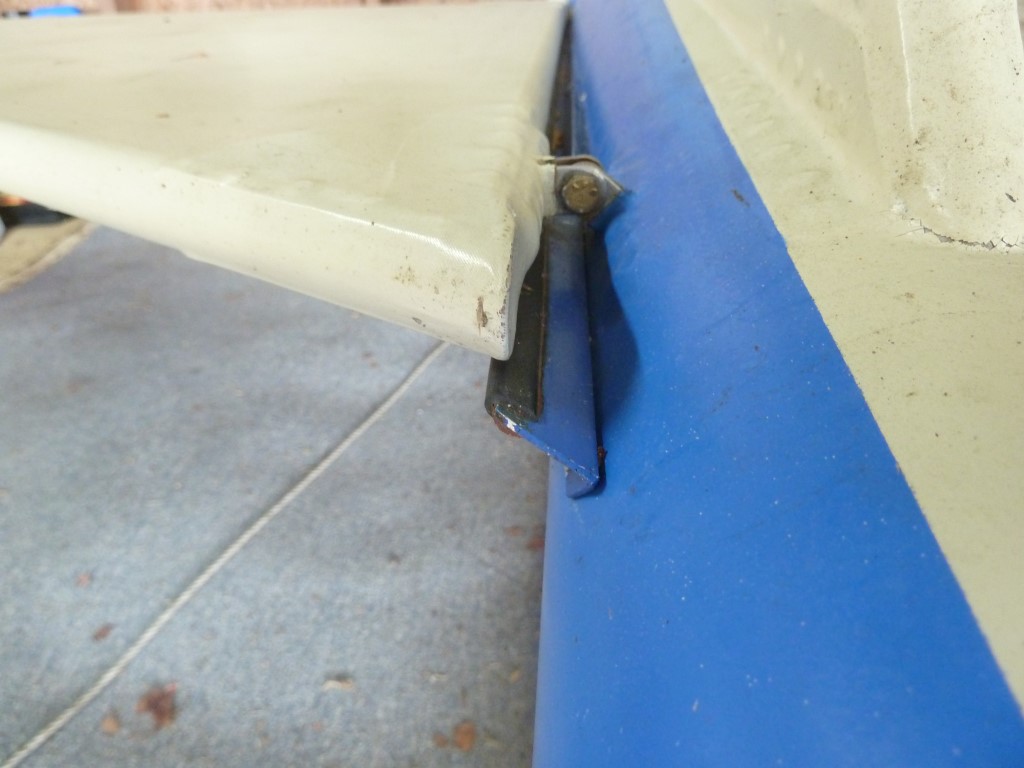

Bill, Can't speak for the Firestar but I expect it would be similar to the Mk III. A proper gap seal and covering the lower frame on the Mk III DOUBLED its climb rate and greatly relieved stick pressure. The PFH had the opposite pitch issue, she was a lawn dart. I reset the wing angle of incidence to the least angle recommended by Kolb and lowered the horizontal stabilizer incidence and she still needed small trim tabs on the elevators. Then she flew with fingertip pressure on the stick.When you do get the HS where you want it, consider making seals for the gap between the HS and the boom tube. If it responds like the Mk III you'll find the rudder effectiveness much improved, to the point that you can level the wings while in a stall just like a 172, something a stock Mk III will not do.
Rick Girard

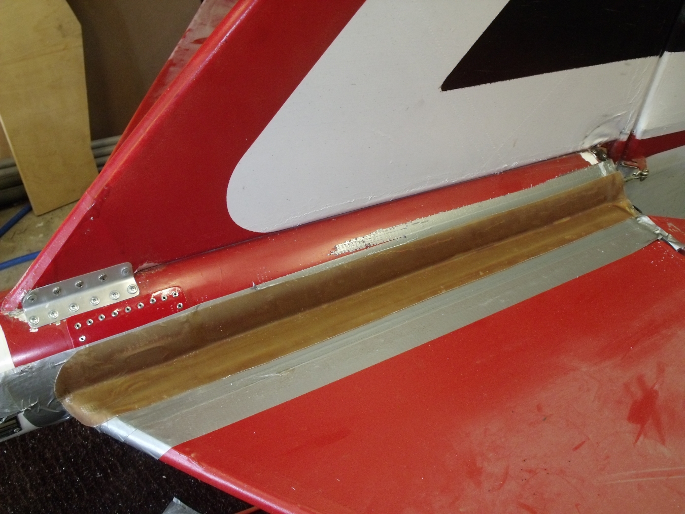

victorbravo(at)sbcglobal.
PostPosted: Tue Aug 21, 2018 10:10 pm    Post subject: Kolb-List:Stabilizer Angle Reply with quote
Thank you Rick, but can you clarify what you mean by covering the lower frame? Do you mean the lower fuselage frame below the fuel tanks, or are you referring to the frame behind the cockpit under the wing, or something else.
I have taped up the gap between the wing and aileron, including the torque tube. It seemed to make a difference but I was not set up for measuring anything.
Bill Berle

Elevator hinges are very difficult to mount exactly centered.  The result is a little fore and aft motion of the horizontal stabilizer.  How do you compensate for that fore and aft movement with tail boom gap seals?
Rick Girard
Richard Pike
Posts: 1671
PostPosted: Wed Aug 22, 2018 6:50 am    Post subject: Re: Kolb-List:Stabilizer Angle Reply with quote
Use a strip of thin aluminum angle, taper it so the front is wider than the rear. Paint it to match your airplane and glue a length of rubber u-channel along the outside edge to barely touch the stab. Allows the stab to move fore and aft a bit, and also to fold.
 Filesize:  120.97 KB
 Viewed:  20274 Time(s)
Richard Pike

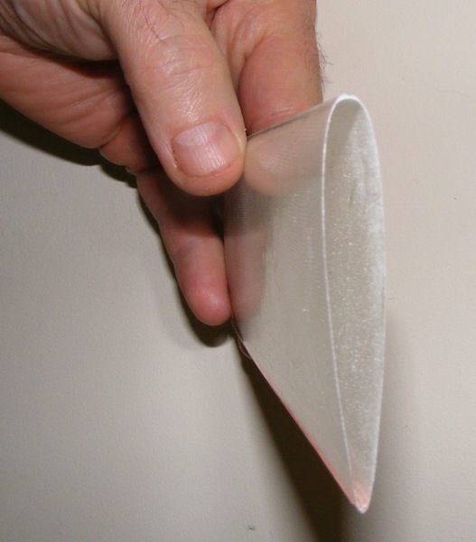

Re: You can do a pretty good job of streamlining the round lift struts with a length of aluminum flashing, folded over and JB Welded (Liquid Nails, double stick carpet tape, etc) to your strut, with some aluminum duct tape around the front side to seal it up. You only fair the rear side. Not ideal, but a great improvement over a round tube.
Or you can get really serious like Jack Hart: http://jackbhart.com/firefly/firefly91.html
I did look at his link. And it makes me CRINGE when I think of someone A) sealing up their most important part, and B) after sanding on the aluminum with a drywall sponge block. Every scratch, (or carbon pencil mark) on aluminum, is where it will break later!!
I have done lots of progressive composite work. The example shown was one piece, with walls as thick as paper, and it weighed the same as one sheet of paper too. While it's not a strut cover application, I'll be making similar sections which are slightly thicker, removable, and won't be scratching the struts either! My stabilizer gap seal will look like the aluminum one posted recently, but will also be of composite materials. Great stuff, no corrosion, no stress fractures!
Jerry

PostPosted: Mon Aug 27, 2018 5:34 pm    Post subject: Kolb-List:Stabilizer Angle Reply with quote
I shimmed the elevator so that it aligned with the pivot bolt. That eliminated the small up and down movement of the horizontal stabilizer.
Rick
