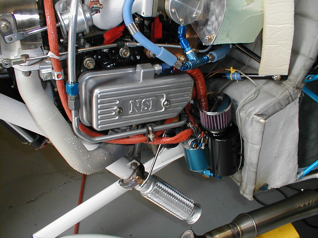

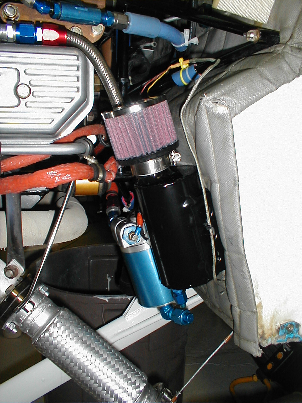

PostPosted: Mon Jun 05, 2006 2:32 pm    Post subject: Specs Reply with quote
Take a look at the ones I ended up making. I got tired of messes and not
having the crud/sludge acid water purged from my crankcase while allow
clean cool air in. OK here goes first attachment.

smokey_bear_40220(at)yaho
PostPosted: Mon Jun 05, 2006 8:58 pm    Post subject: Specs Reply with quote
Rick, John and Matt,
Rick and Matt, The attachments came thru OK as
thumbnails, but the first one downloads as a black
pic. I tried twice in Corel Photohouse. The second
one is OK.
John, I had a 1/2 qt of oil blow out the factory
breather on my first flight. It flooded onto my right
cockpit floor and aft as well as blowing across my
right door in and out.
Got my attention! I thought I blew an oil cooler
line, but the pressure was good, so I landed under
power.
Fixing the breather system was my first priority in
testing, after an exensive cleanup of plane and
underware. Sad
Like Rick, I put in a system that doesn't recycle oil
back to the pan. Otherwise I could have just
installed a PVC valve on the pan return. Mine has a 1
qt race car collector that I have to drain
occasionally. It looks similar to Rick's, but he has
2 and both sides go into my one.
I removed the attachments on top of the valve covers
and attached large barbed hose couplings. One is
verticle and the other is at a 45 degree angle up to
clear other parts. The hoses go constantly up to the
collector so that good oil can drain back down after
it seperates. I was concerned because it would blow
that 1/2 qt out and I thought it would all blow out on
a long flight if I didn't let it drain back down the
hose. The bad stuff drops into the collector. Later
I did install a bit of scrubbie into the hoses held in
by the barbs to calm things down a bit like the
origional hose connectors.
I think I used 1/2" ID hose to let it breath well. In
total, what I took out weighed the same as what I put
in.
My understanding of the auto Soob is that it had the
PVC valve in place to allow air to enter the right
(airplane) cover and exit the left as it seemed to
naturally want to breath. That may explain why you
get oil out the left only John.
I eventually replaced the dipstick because the
origional only showed the top qt of oil of 5 qts.
That turned out to be too much oil and I wanted to
know how much I had when it wasn't that full. 4 qts
was the last 1/8th inch of the old dipstick. This was
due to the taildragger configuration with the dipstick
at the front and the oil leveling to the rear with the
tail down. Now I run 4 qts with a good dipstick I can
read. And oil blowout is maybe a cup or less in 10
hrs.
Keeps the plane clean as Rick said. Smile
Darn Soob replacement dipstick was $20! Couldn't find
one to recycle. Sad
Kurt S.

janderson412(at)hotmail.c
PostPosted: Mon Jun 05, 2006 11:40 pm    Post subject: Specs Reply with quote
Thanks Rick, both shots came out extra good. The system drops the blow by
oil into the container and the filter is to ensure clean air return? As Kurt
explained, you would drain the container every so often? Your turbo set up
looks almost identical to mine, I see the cable that was fr the manual
w/gate, yes?I went through that too but reverted to std system. John
From: "wingsdown" <wingsdown(at)comcast.net>
