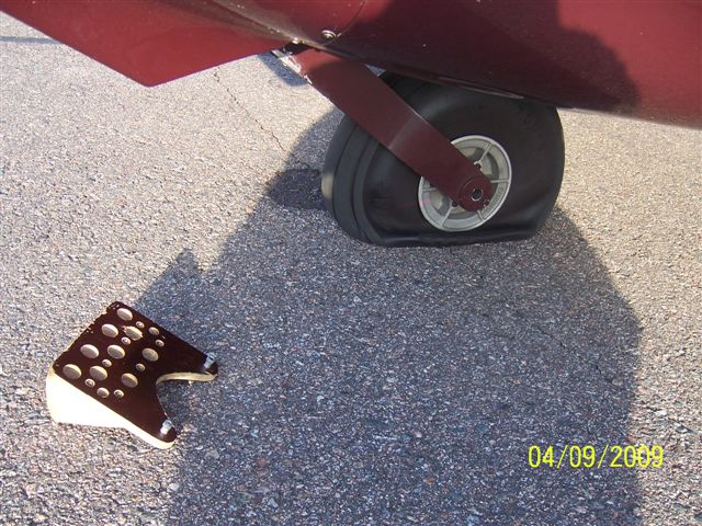

I have lost without visible or known reason two innner tyres in my Monowheel.
Loosing suddenly main gear´s air pressure is not a funny game and did not make my day actually.
Both of them have been original -Europa supply.
That means they are Indonesian made Deli Co´s "Nanco" 8.00 x6/7 TR-87 -type.
Both times I have found a very little crack (dry rot they say) on the sidewalls.
Google "Nanco problems" ...
Main /outer tyre (Airtrac) is unhurt and a new like.
May I please get a recommendation about a good quality inner tyre?!
Kind Regards,
Raimo from Finland
OH-XRT 139 hrs 280 landings

PostPosted: Fri Sep 18, 2009 12:45 am    Post subject: Mono Inner Tyre Failures Reply with quote
Terve!
I cannot accept this! It should not be a part of our life we live (and fly) nowadays !
Landing with empty tyre could hurt seriously in the worst case scenario.
There must be something to prevent this happening so often or even better - never!
I used also talcum powder and now the whole plane smells roses (I asked powder with jet fuel smell but they have not!).
What´s your tire pressure, Paul? I have used always 2,2 PSI = 2,4 kg/cm2 (that´s about double they recommend).
BTW it is easy to check: in my case 2,2 PSI equals 162 mm = 6,38" from the asphalt surface to the lowest point of the main axle (port side). That is a poor man´s Mono Main Tyre´s Pressure Gauge.
Raimo OH-XRT

XS Monowheel.
--- On Thu, 9/17/09, Paul McAllister
<paul.the.aviator(at)gmail.com>
wrote:
From:
Paul McAllister
Subject: Re:
To:
europa-list(at)matronics.com
Date: Thursday, September 17, 2009, 12:32
PM
--> Europa-List message
posted by: Paul
McAllister <paul.the.aviator(at)gmail.com>
Hi,
I
have this happen regularly.  I now just
change them every 100
hours
and I never travel without my jacking block and a spare
inner
tube.  I
have tried inner tube talcum powder and different
pressures with out
much improvement.
The failure mode seems
to be chafing on the side wall due to running
such  low
pressure.
Paul

I have been following this thread on flats, and I have a few points to make, that have worked for me.
I have been flying my monowheel almost ten years off paved runway's...My kit included the old "tundra tire" and instructions to use low pressure,(I don't remember PSI, but the sidewalls rubbed the Landing gear frame.) The plane taxied like it was runing in mud..
I changed that tire at about 20 hours to a 700 X 6 and 6 plys and used 30 PSI. The plane is much easier to taxi, take off's are much quicker, and in 800 hours I have replaced two tires that were worn out. No flats !!!! I can't say that the air pressure is the problem, and also I don't fly off grass, but I have not had the problems that so many of you are having.
On another note having made the above change I also changed the outrigger lengths, as the new tire, with higher pressure made the original outriggers to short. Over the past ten years I have extened the outriggers in length, to now when the plane is parked, both outriggers touch the ground. For me ground handling is much better, and in landing with the longer outriggers the "rocking from one outrigger to the other" is now gone.
Also another question ? Are the flats limited to the Monowheels ??? Are are the tri gears having this problem?
Jim Brown

I think this is the 4th set of outriggers I have replaced over the years. Each set was made longer,about 1/2 inch each time. My monowheel is an XS model,and not the classic so there may be a difference in lengths of the outriggers as supplied by the factory???
In looking back when I was learning to land the monowheel, FOR ME I think the learning curve would have gone better had the outriggers been longer... Let me explain....During landings,after touchdown, the rocking from side to side of the wings with the short outriggers gave me the inpression that the plane was starting to turn to one side or the other, and I sometime corrected for a turn, when there was no turn. It took a while for my brain and my feet to come togather in my mind. Before I started flying the monowheel, I had acculuminated 1000 plus hours in a Pitts S-1-S which I owned. My perspective of what was going on outside the monowheel during the landing roll out, was affected by what I had seen in the Pitts.
I'm not sure how a low time pilot might feel, or be aware of what is happing in the landing roll out of their monowheel.
I don't know if anyone has posted their thoughts on this subject.....but please DO NOT change out the outriggers on your plane on basis of my experience.
Please understand I am not suggesting that anyone run out and change outriggers for longer ones.
Jim Brown.

<?xml:namespace prefix="v" /><?xml:namespace prefix="o" /><![endif]--> Interesting to note:
Tire pressure is the key. The lower the pressure the more wear on the side wall. I see the older mono's with cracks in the sidewalls running 12-14 lbs of pressure on the 7 inch tire so as to control the bounce (theoretically). The normal pressure by the book for the 8 inch tire is 18 lbs. But none is stated for the 7 inch tire in the operations manual... Typically the tire should be inflated to about 30 lbs according to Air Trac.
The original outrigger length was set for the Classic tail wheel located at the rear bulkhead. The tail wheel was lower and the outriggers were shorter. With the tail wheel stinger, the outriggers were too short and were eventually lengthened. The new tail wheel conversion mod for the old Classic tail wheel to stinger increases the outrigger length by about an inch and a half.
After talking years ago with Jim Brown and Andy Draper, I helped Joe Like set up his aircraft with the longer leg lengths. Joe was a low time pilot with a little Aeronca Champ time. By adjusting his outrigger leg lengths to just rest on the ground when the plane was only loaded with fuel, helped him with the horrible leans that can throw off the novices attempt at directional control. Joe has the 7 inch main tire as most of you all. Joe now has 150 plus hours without incident operating off of concrete. So Jim has sage advice.
Each plane requires a slightly different outrigger measurement, but it appears worth the effort to make the outriggers so they just touch the ground so as to help overall control.
Just my thoughts. I only have a few landings in the mono, and the weather was calm. No ill affects with this setup. I also never allowed a deviation more than a inch or two on takeoff or landing. Let's just say I had happy feet and a tight set of muscles.
Bud Yerly

FWIW, in heavy transport, tyre pressures are vital in ensuring tyre life, a tyre than underinflated
by as little as 10% can and does have its life shortened by as much as 95%, due to excessive flexing
of the side walls causing overheating and delamination, which generally results in total and complete
failure with little to no warning. No doubt some of you would have seen a truck tyre explode on the
freeway for no apparent reason

PostPosted: Mon Sep 21, 2009 4:12 am    Post subject: Mono Inner Tyre Failures Reply with quote
OM XS Monowheel August 1998 Page 7-4:
- tyre pressure for correct inflation - 18 PSI (1,2 bar)
Is not that too flat?
I have used almost double (2,2 bar)
No landing or handling difficulties.
Raimo OH-XRT
