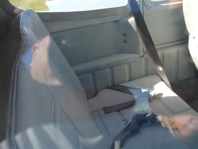

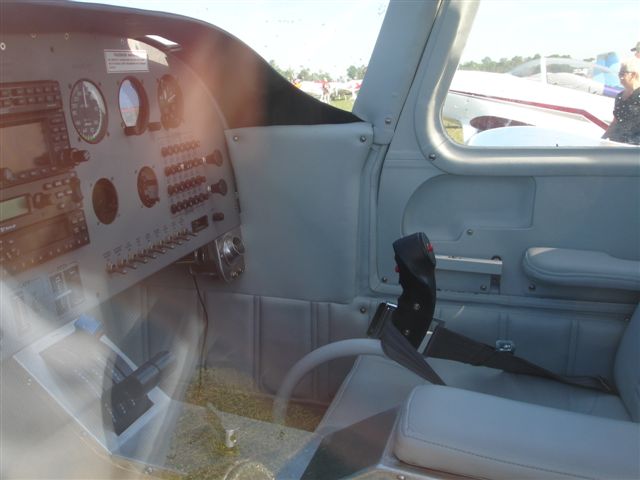

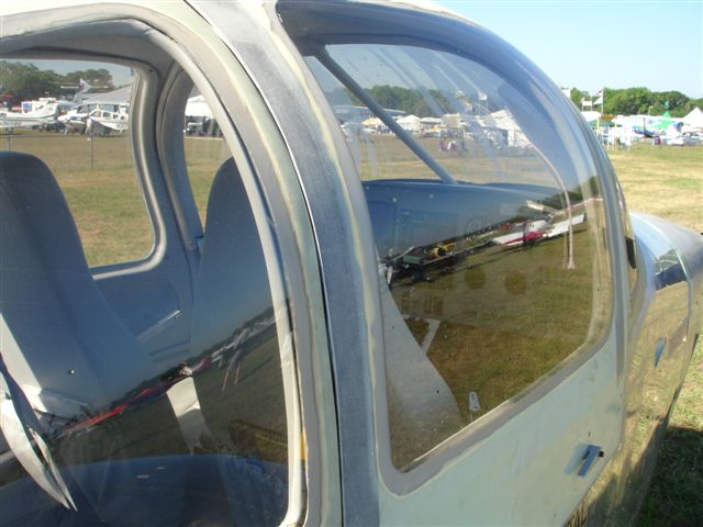

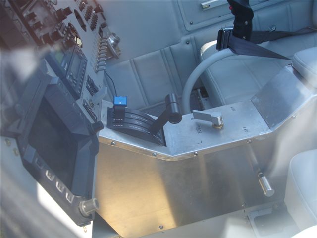

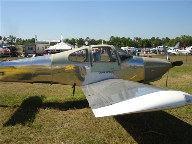

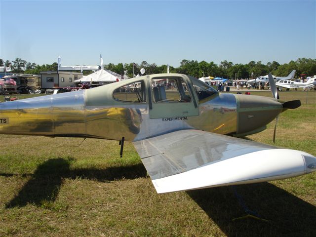

I got to see Tru Trak's RV10 at SNF. Though not painted yet, the interior looks finished. I snapped some pics below.

Anybody know what kind of a prop they have on it? It's 3 blade is it an
MT? or Aero Composite?

If it was at Sin/Fun, it is a three blade MT.

It is aero composite.

Ok, here are the numbers that we got from our test flights earlier in the
year. We could not remember the air temp. Engine is IO-540 prop is Aero
Composite 3 Blade. The 10 is unpainted.
At 7800' - 23" - 2300 RPM - 196 MPH. We both question this number because
it just doesn't seem like we should be able to get 23 inches of manifold
pressure at 7800'. But that is what the EIS was showing. We also did not
have a fuel flow at this altitude. When we increased the RPM to 2400 we got
202 MPH.
Now at 1000' - 21.5" - 2400 RPM - 14 GPH - 196 MPH. Once again these are
the numbers that we saw. They don't seem quite right given the manifold
pressure just seems too high for the altitudes.
We are planning another round of testing in the future and I will post the
numbers as we complete the tests.
We are VERY pleased with the Aero Composite prop. Flying the 10 with the
540 and 3 blade is amazing. The 6 cylinder and 3 blade combo are so very
smooth that you think that you are in a turbine. The only thing that I
don't like about the 3 blade is taking the danged cowling off and putting it
back on!
Oh and for those that wish to know we have about 90 hours on the 10 now and
it is a fantastic aircraft.
