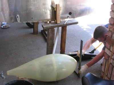

PostPosted: Mon Mar 03, 2008 1:02 pm    Post subject: Jacking up the -10 Reply with quote
I went down to harbor freight, and they were having a sale on lift
tables. I bought one, modified it a bit, and it worked like a charm.
See here:
http://www.perfectlygoodairplane.net/Perfectlygoodairplane/Landing_Gear.
html
it was just the ticket for doing the wheelpants and gear leg fairings.
I used a heavy duty saw horse under the tail, and adjusted the height so
that the aircraft was level.
cj

<?xml:namespace prefix="v" /><?xml:namespace prefix="o" /><![endif]--> Hi Rick,
Yes, I welded a bolt at about a 45 degree angle to a cut piece of galvanized pipe, and covered it with epoxy and micro-balloons. Wrapped the inside of the pipe with a strip of inter-tube to prevent scratching and to add friction. The bolt fits in a hole drilled in the top of the scissor jack (from Kragens). Using an electric drill with a "tee" makes for easy jacking.
Roger

Two or three pallets with the top one covered with a carpet scrap. Then use various shims to ensure level across the fuselage. That ws my method and it seemed fine, especially after dropping many plumb lines and square lines on the floor to cross-check in-plane.

Very cool, I was looking for a way to jack mine easily from the gear, I have mine on Harbor Freight dollys and I can see using them once flying to get the most from our hangar space (Bob Kauffman and I) we have 3500 SF and rent out what we don't need. The dollys allow us to move the aircraft easily into the corners...we inconvience ourselves but not our tenants...looks like an aerolift may be on the way. Hangar space at North Las Vegas is sparce...we are lucky to own the facility we have. Once the fly off is done and the fairings are on for good I'll have to jack from the wing tie down to put it on the dollys...small price to pay for "free" hangar space.
