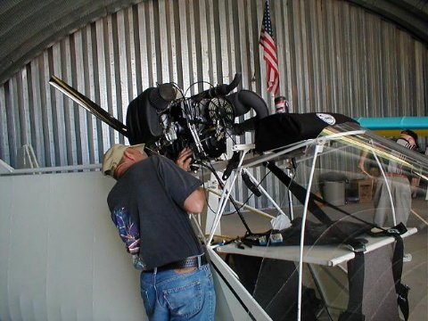

115 dB(A) is about right for my FireStar and I have an intake silencer plus the exhaust silencer.
Other pilots would tell me when they heard me over the radio there was too much noise picked up by my David Clarks. The ANR works great but I found the ANR annoying to the point that on long flights it was better when I turned it off.
I changed to Comtronic headsets and put the mic touching my lips, now the other pilots can hear me much better. I use Classic Foamy ear plus so I can raise the volume up and not worrying about hearing loss. The ear plus also protect me from the noise that leaks into my headsets via the sunglasses frame temples.
When flying the Piper Colt I use Lightspeed QFR Soloc with the cell phone patch cord. The cell phone doesn't work unless the headsets are hooked into an intercom so I haven't tried them in my FireStar.
When flying in Thom Riddle's Allegro 2000 912UL we averaged about 100 dB(A) for the durations of the flight.
