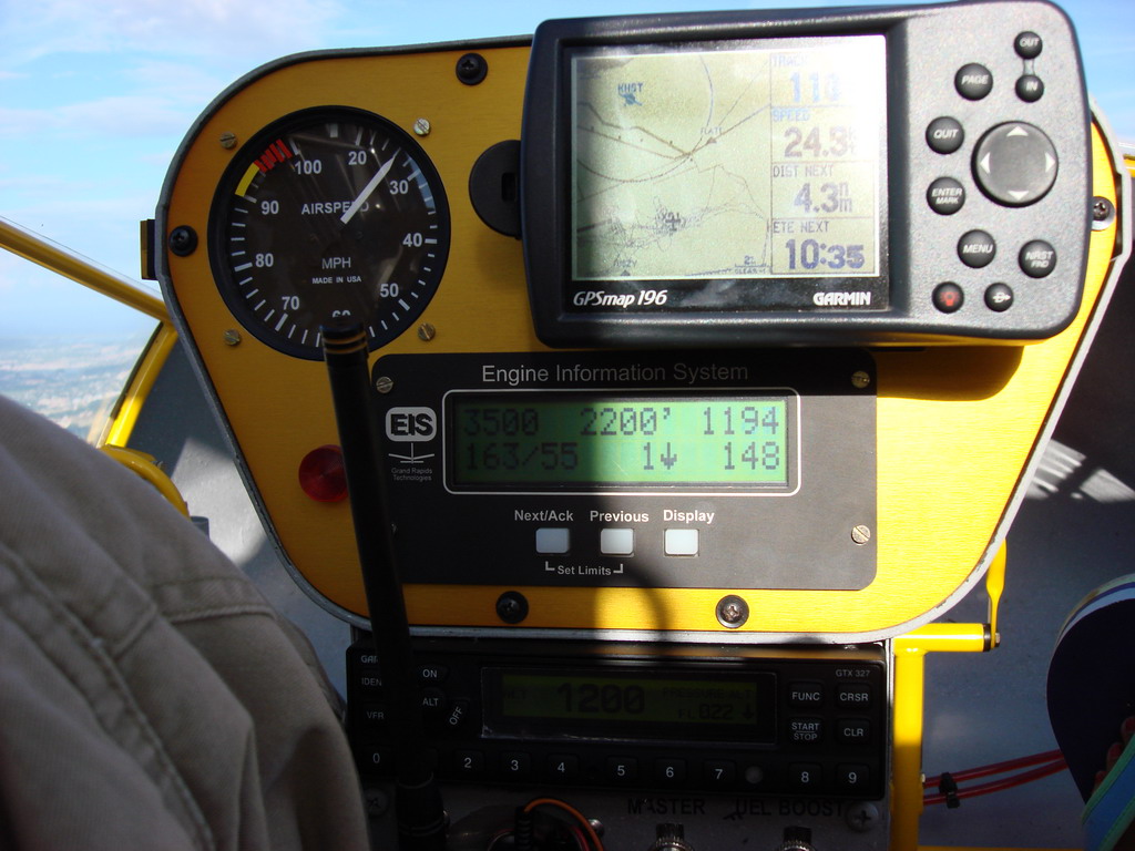

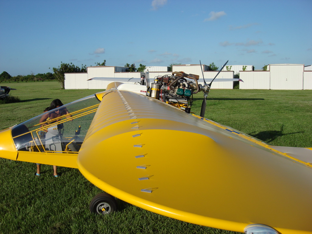

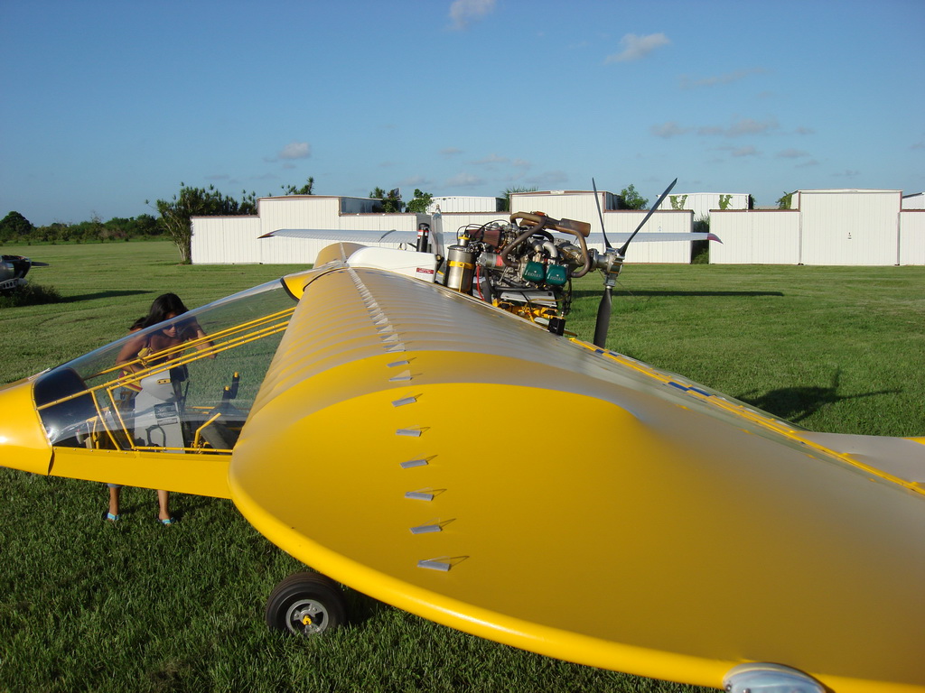

Grant,
Your experience with the higher stall speeds is normal. Adding VG's to your Kolb will get that stall speed down to where you want it. I had close to the same stall speeds with my MK III Xtra, which is much heavier than yours, and putting VG's on it made a new airplane out of it, not just in stall speed, but the way it felt throughout the lower speed range. Below is a shot of my panel during slow, right on the edge of stall, level flight.
I put about 140 VG's on my wings, from the center right out to the very tips of the wings. Its critical to install them very precisely, but if you do you will be well rewarded.
Mike
Level flight with VG's
 Filesize:  193.31 KB
 Viewed:  629 Time(s)
Kolb MK-III Xtra, 912-S
Mike
Mike B:
Has a critically precise location been established for placement of VG's on
Kolb wings?

Mike,
After I finish the repairs on my FS I, I plan to put VGs on it. You stated that precise location of the VGs is important. Since all the Kolb wings use the same airfoil (I've heard) I would think what works for the MkIII will work pretty well with the rest of the Kolbs. Would you post the details of your VG installation? Various Kolbers have posted their methods of locating their VGs but, I'd like to hear about yours too.

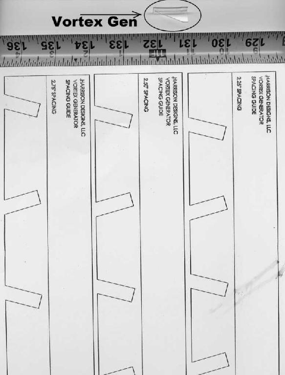

I am interested in the VGs as well. Do you have a plan/ drawing to follow to make these? Did you use aluminum flashing material?

I have had an outside static source on my Kolb from the beginning, so there are no pressure errors in my system. I have also checked my airspeed readings with the GPS you see in the picture under no wind conditions, and again everything is accurate.
Precise placement of the VG's has been determined by the manufacturer, they are not airplane specific, but its about the same for most general aviation airfoils. The angles of the VG's into the wind are especially critical as is thier design. I put them on exactly per the instructions, and the result was an incredible difference. You can get the VG's at:
http://www.landshorter.com/
There is another Kolb MK III with a 912 based at my field, its "Fat Albert" as some of you remember that plane. The difference between landing that plane and landing my plane is huge, the other MK III has to be landed very fast, and with power to keep it from dropping hard onto the runway much the same as described by Grant. My MK III can be landed engine off, approaching at 50 MPH and result in a soft landing. The "Fat Albert" pilot could not believe the difference between the two MK III's.
In a nutshell, the VG's eliminate the "Kolb Quit" where the plane just drops into the runway if you get it to slow. I generally do three point landings, but many times I touch the tailwheel first at less than 30 MPH indicated, no problem, the mains just come down very nicely. I will take some videos of this and post them on You Tube.

Mike,
Many of us make our own VGs and would like to know the precise location (and angle) you used per the manufacturer's instructions. Will you give us this information? Of course, you are under no obligation to do so but, if I don't ask, I won't know. How about it?

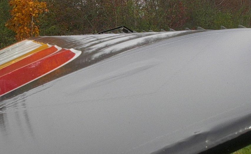

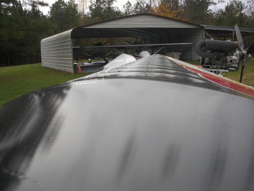

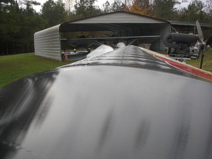

If you are going to use the "Landshorter" VG's you would naturally follow their instructions on where to put them, as they seem to have already done the wind tunnel tests and are selling them to the ultralight community knowing the type of planes we are putting them on. Mine are at the suggested 10% to 12% (of the cord of the wing - including the ailerons) back from the leading edge = about 6.5 inches as measured thru the cord. www.landshorter.com I went to an "auto paint store" and got the "good" double stick tape.
Automotive Acrylic Plus Attachment Tape
Stick it on the bottoms of the VGs, then cut around the edges with an
exacto knife.
When you putting them on your wings, you just pull the paper off the
botton and stick them down.
Haven lost one yet.
The instructions say put them on 10 to 12% of the wing cord (including the
ailerons)
back from the leading edge. Too far forward and they will slow down the cruise
speed, too far back and they become ineffective.
I put mine about 11% or 6 1/2 inches back from the leading edge as measured
through the middle of the cord of the wing - average cord.
But you better check with the instructions.
The instructions say VG's should be placed about 1% of the wingspan apart.
I have a 27' 9" wing span.
So I put two in each valley and used the 2.75 inch spacing guide
to "kind of space them out" between each rib and false rib etc.
Just a guess, but it seemed to work out OK.
I used the guide they sent with the little "rectangles" cut
out where the VG's go, so I could just stick them in the holes
and move the guide to the next valley.
I just put two on at a time and moved the guide to the next set of ribs.
I used the T-square method like Ben Ransom for the set back
It took more time to put the tape on each VG than it did
to put the VGs on the plane.

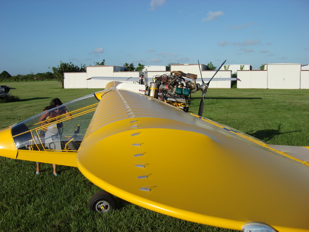

Sure Tom,
The angle into the wind is 15 degrees " Nose In " between each rib valley. Spacing is 2 1/2 inches all across the wing, but centered in each rib valley. They are placed 10 % of the chord back from the leading edge of the wing. I am flying at work right now, but if you like I will give you the measurements of the VG's when I get home. BTW, the VG's at www.landshorter.com are cheap, only 100 dollars per 100, and they are much nicer looking and stronger than I could ever make them. Attached is a picture of the VG's on my plane, I used about 140 of them.
Mike
VG's on my MK III Xtra

One Correction,
Possums is correct about the spacing being 10 % - 12 % of the wing cord back from the leading edge, I put them right in the middle at 11 %. Also, remember not to measure the curved part of the wing, that distance is straight back from the leading edge not measuring along the curve of the wing. I used a carpenters L up against the leading edge of the wing, with the side of the L parallel with the bottom of the wing to measure this distance. This way I could measure accurately how far back on the top of the wing without the curve in the airfoil throwing my measurement off.
On the MK III the ribs are spaced at 5 inches apart, so 2 1/2 inches allows you to center them in the valleys and have constant spacing along the entire wing. You might have to vary the spacing just a hair between VG's from one valley to the next to get them in the middle each valley, but they recommend that each "Pair" be centered in each valley.
