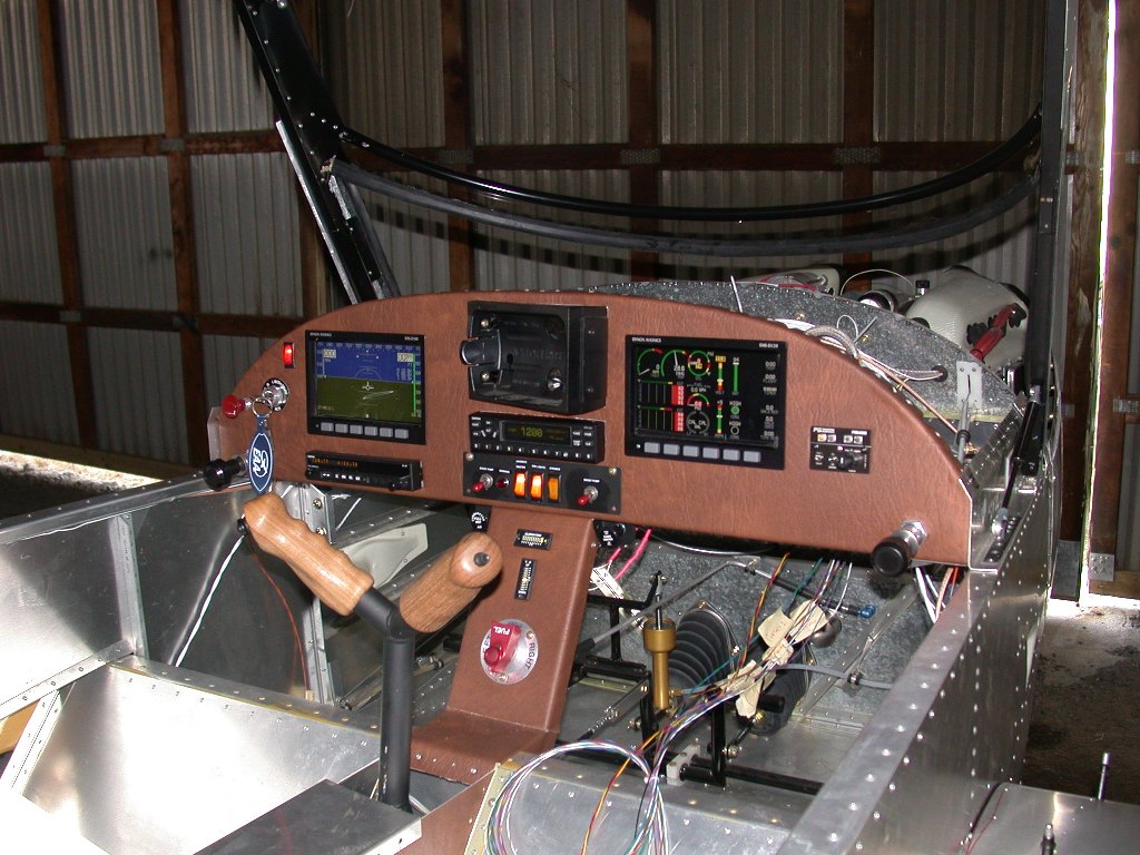

PostPosted: Sun Dec 16, 2007 2:41 pm    Post subject: carbon monoxide Reply with quote
Carlos,
Attached is a picture that shows the aluminum fuel line going from the Andair selector valve running to the firewall and down to a AN bulkhead fitting on the lower right. The Gascolator is on the other side of the bulkhead fitting. The standard ZAC quarter inch inside diameter synthetic rubber fuel lines come from each leading edge fuel tank through a filter and Facet pump next to the tanks to the selector valve. Fuel pressure sensor, 3300 mechanical pump, and final filter are in front of the firewall.
Jeff

Just about everyone has a different idea on this topic.
My thoughts are, I am comfortable with my rubber bellows packed full of ceramic wool. It takes 2400+ degrees f to degrade this material. I have seen several guys build some pretty nifty slider/shutters to seal up those pesky steering rod slots. If you get a fire hot enough to burn up my style of seal then it will weld up the slider/shutters till they won't operate. On landing the steering rods are gonna move up and down and left and right, with those sliders/shutters rigid there is a good posibility you will lose control and crash. The zenith design is somewhat problematic so each to their own when it comes to sealing up those slots. Remember, the steering rods are moving in two axis's, up and down and side to side. I hope to never test my design because there is two things that scare the crap out of me. One is burning to death in a plane or racecar and the other is suffacating while buried in an avalanche. As for you thoughts on the cowling, you are 100% correct, if the fire is that intense to start burning through the firewall and its thru connectors the cowling is going to be burning like Richard Pryor on crack running down the road. YMMV.
