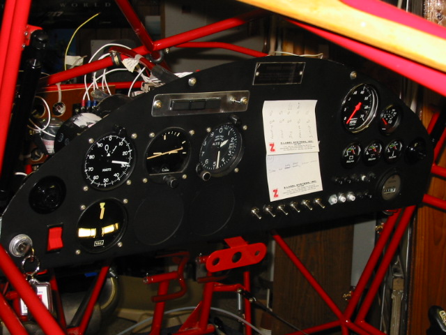

My classic IV has all of the speedster mods and a full panel with a Stratus Subaru and weigh in at 750. I am using 17 ½ deg on the prop and getting a top speed of 120 and a 75% cruise of 95

 Filesize:  108.75 KB
 Viewed:  580 Time(s)
