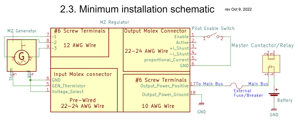

The Monkworkz 30A PM alternator is in production. I'd say at this time it's for early-adopters. Ref VAF thread https://vansairforce.net/community/showthread.php?t=206179
It cannot be connected directly to the battery because it presents a passive load that will drain the battery. “there is a resistive voltage divider on the output that keeps tabs on the output voltage and that will over time drag your battery down”
It is said to start and work well with battery disconnected.
Question for Bob and others… best way to incorporate it into Z101? Simply a 40A automotive relay between alternator and battery?
You can download the installation manual at https://monkworkz.com/

PostPosted: Tue May 17, 2022 12:24 pm    Post subject: 30A PM alternator and Z101? Reply with quote
Okay, as a MAIN alternator, it would drive the main
bus. As a standby alternator, it would need a relay
to isolated from the battery.
BTW it is said to start and work well with battery disconnected.
Great!
I believe so . . . or fat diode. This could be easily
explored/confirmed.

johnbright
Joined: 14 Dec 2011
Posts: 167
Location: Newport News, VA
PostPosted: Wed May 18, 2022 6:01 am    Post subject: Re: 30A PM alternator and Z101? Reply with quote
Ceengland wrote:
If OV protection is used, You'd need a relay on the output anyway.
... I'd also bet that there's a little wide-ratio planetary gearbox in the nose, to get the magnet spinning fast enough to make that kind of power when mounted on the low rpm vacuum pad.
Anyone know if it's an 'outrunner' or 'inrunner'?...
OV protection is in the regulator.
It’s an outrunner, the outside case spins.
No gearbox in the Monkworkz PM alternator: “Yep, it's direct drive, the only thing between the generator shaft and the vacuum spline gear is a shear coupling. Bill at Monkworkz.com”

PostPosted: Wed May 18, 2022 9:05 am    Post subject: 30A PM alternator and Z101? Reply with quote
Here's their installation data:
http://aeroelectric.com/Mfgr_Data/Monkworkx/MZ-30L%20Installation%20and%20Operation%20Manual%202021.pdf
Seems it has a 'outrunner' style magnet housing
like most PM alternators. It's a 3 phase machine
which goes a long way toward achieving this power
density . . . along with forced air cooling.
I took a quick look at their web page, and it seems a safe bet that it's a high output brushless DC motor (really inverter driven AC) like you'd see on a big RC plane, that's being used as a generator instead. I'd also bet that there's a little wide-ratio planetary gearbox in the nose, to get the magnet spinning fast enough to make that kind of power when mounted on the low rpm vacuum pad. Anyone know if it's an 'outrunner' or 'inrunner'? I'm thinking something similar to this:
https://hobbyking.com/en_us/turnigy-l3010b-1300-brushless-motor-420w.html
Yeah, adapting one of those products to this application
would require a step-up gearbox . . . which is
exceedingly difficult if the driven mass has much
rotational inertia. We note that the Monkworks
machine's outside diameter is quite small compared
to other products . . . barely larger than the
footprint of the vacuum pump pad.
The companion electronics has ov protection built
in. It also needs forced air cooling . . . not
surprising given it's small volume and footprint

I exchanged emails with Bill Judge at Monkworkz. He expressed concern the battery alternator's regulator could register an OV event if the battery alternator relay was opened while the alternator is delivering significant current. I brainstormed several configurations and posted them at https://drive.google.com/drive/folders/1EP07O-9srhEHeR6za8DwbJBh0cdGIK50?usp=sharing

PostPosted: Tue Jun 07, 2022 4:30 am    Post subject: 30A PM alternator and Z101? Reply with quote
At 03:43 PM 6/6/2022, you wrote:
--> AeroElectric-List message posted by: "johnbright" <john_s_bright(at)yahoo.com>
I exchanged emails with Bill Judge at Monkworkz. He expressed concern the battery alternator's regulator could register an OV event if the battery alternator relay was opened while the alternator is delivering significant current. What I came up with is a progressive off / enable / on switch for the regulator and a Schottky diode to shunt any voltage spike to the battery. Ref attached pdf and its notes 2, 7, and 8.
This posting seems to 'worry' about a transient
event that is not well understood. Exactly what
are the conditions that set up the possibility
for the adverse event (spike to the battery?)
What is the energy signature of the event (watt-seconds,
duration) and what components of the system are
at-risk for having suffered the event?
Has the event been demonstrated on the bench?
out of that stuff?"
PostPosted: Tue Jun 07, 2022 4:41 am    Post subject: 30A PM alternator and Z101? Reply with quote
The narrative speaks to a 'backup alternator mode'
and a voltage reduction option in the connector wiring?
What for? Suppose you're flying along sipping coffee
and listening to your favorite tracks on the stereo
and the main alternator quits.
What, if any, emergent condition exists that drives
a requirement for automatic change-over to the
standby alternator? If you've incorporated this
feature in your system, how will you know that the
change-over has taken place?
Is there a requirement for proper sequencing of
switches for normal operations? My design goals
strive to generate no hazard to system components
by a mis-placement of switches. Is it perceived
that the proposed system has such a risk? Has
the risk been demonstrated on the bench?
out of that stuff?"

The diode parallels the relay contacts. When the contacts open, the diode will carry full alternator
output which will destroy the diode which is rated at only 4 amps. Why open the relay in flight?
I interpret Bob's posts to mean that you are worrying about a problem that doesn't exist.

PostPosted: Tue Jun 07, 2022 7:37 am    Post subject: 30A PM alternator and Z101? Reply with quote
. . . or more to the point, under what conditions is
the relay energized/de-energized? Why would one have
this relay closed in normal flight?
Recall that the 'auto switch over' feature for the standby
alternator was a concession to TC aircraft manufacturers
when the legacy pad-driven alternators were being
considered for Beech and Cessna products.
I argued that it was an unnecessary complication and
expense added to a simple solution. OBAM aircraft are
EXPECTED to have active notification of low voltage.
The time between notification and pilot action to
to implement plan-b is not a critical issue. Whether
this is 10 seconds or 10 minutes is of no significant
consequence.
So why add the electronics to automate the process?
Note that Z-101 suggests the standby alternator have
only a pilot operated on/off switch and no

I created some pdf files "Elec Schem with Monkworkz MZ-30L as backup and Z101 as a template...", too large to attach so https://drive.google.com/drive/folders/1wCRqBknCU6JXPrNTm0PMvXaXHlPn2v2A?usp=sharing
Bob:
    I don't understand why the regulator would generate a voltage spike if disconnected from the battery while delivering a significant level of current.
    Bill Judge of Monkworkz said "It's possible that the OVP would be triggered by switching off the relay when there is significant current flowing. No damage will occur but you only get three of those per engine start. Around 15.3 V is where an OV event is registered, and the duration needs to be on the order of 10 ns or more, way faster than DO-160 requires."
    I was trying to address his concern by adding the diode across the relay.
    The voltage spike has not been demonstrated on the bench to my knowledge.
    Alternator backup mode:
      I understand that it's not necessary.
      The crew will get an indication on the EFIS or panel light if the alternator wakes up from backup mode when the voltage drops to 13.7. Ref the Active High connection on the regulator.
    The only configuration that has any sort of switch sequencing SOP is Configuration 1 where the progressive battery alternator off / connect / on switch should not be moved quickly from on to off in order that the hypothetical voltage spike would not be created. If this switch is moved quickly from on to off and if the hypothetical voltage spike is a real thing, the diode across the relay will shunt said spike to the battery.
Joe: AFAIK the 1N5822 diode is rated at 3A (IF(AV) under certain standard conditions) which is OK because the alternator is off when the relay contacts are open.
I don't have a Monkworkz alternator to experiment with rather I'm trying to plan ahead in case this product proves itself in the field. I see it as being in the early adopter stage at present.
John Bright, RV-6A
This makes no sense to me. Switching off the
'b-lead' relay can suddenly unload the alternator
which will undoubtedly experience some magnitude
of load dump surge. But where will it go and
what risk for damage exists? He of all people
should know.
Perhaps it would be well for him to explore this
question?

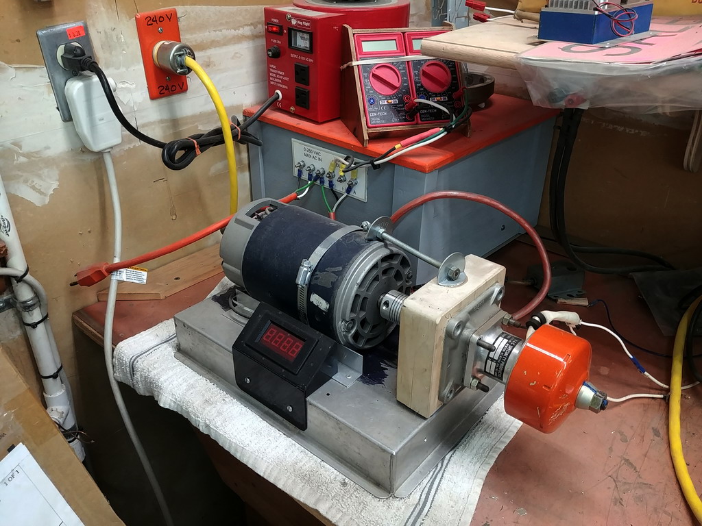

If you're being recruited as part of the Monkworkz
product development team, then one would want to
do some bench testing to confirm/deny the hypothesis.
I've got a AN20000 drive pad test stand whereupon
such questions could be explored.

Not recruited rather a sort of an uninvited volunteer / masochist. I’m gonna stop here until such time as I have a Monkworkz PM alternator on my yet to be completed AC.
Bill at Monkworkz runs bench testing by spinning the alternator with a drill press. Ref YouTube channel.
John Bright, RV-6A
Not exactly a precision test instrument. Next time
you talk to him, suggest that I can plot efficiency
and performance curves with some degree of confidence
along with quantification of the 'spike' theory.
. . . suitable NDA provided . . . of course.

I have communicated by email and telephone with Bill Judge of Monkworkz.
I passed along your offer of doing performance testing and evaluation of the spike that trips OV protection if the B lead is disconnected under load. At present Bill plans to keep testing in house.
Present Monkworkz documentation shows the B lead connected downstream of the master contactor. Perhaps Bill will come up with a recommended Z101 implementation. I shared my brainstorm configurations from post 9 with him.
Bill has a customer who connected the B lead to the battery using a relay independent of the master contactor and has hit the OV protection by opening the relay under load. This does not happen with the B lead connected downstream of the master contractor.
Per Bill:
“Why does this happen? Well, there are inductors inside the regulator, you can't instantaneously change the current in an inductor, the current has nowhere to go and causes a spike. That spike gets mopped up by a massive (1.5kW) TVS diode on the output but that doesn't kick in until the voltage goes over ~16 V, and the OVP kicks in at 15.3 V.
The generator has nothing to do with the spike. The output of the generator is rectified and sent through a voltage converter, the voltage converter is causing the spike.”
