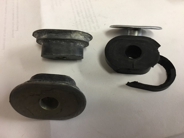

Typically, the rubber used in these engine mounts deteriorates with age. Personally what I would try to do under your circumstance is to measure a new one with a durometer, and then have a mold constructed and replace them with a polyurethane equivalent.
You did not ask this, and I am sorry for sticking my nose into the topic and changing the subject somewhat, but I would suggest that you also make sure you have the Russian recording accelerometer installed in your 50, (or a suitable replacement) and are keeping track of the cycles. The 50 is indeed rated to +9/-6 assuming all the mods are incorporated. However that was not an unlimited qualification. Meaning that after so many "cycles" (as documented on the recording accelerometer), it was a requirement to replace the wings. Considering most 50's that were flown in unlimited events were usually retired under 100 hours of flight time, it might be worth keeping in mind.
The kind of damage to engine mount rubbers that you are describing is something commonly seen on Sukhoi's flying Unlimited level aerobatic competition, usually with engines just like yours and MTV9-260 props, thus I suspect you are approaching that kind of G loading. That said, the Suke construction otherwise is much stronger than the 50. Another thing that generates this kind of stress is gyroscopic maneuvers usually accompanied by prop shaft seal damage.
Good luck.

Mark. I asked for help .....not a lecture on a subject that I am well versed in nor assumptions that are incorrect
I have solved the problem and I am surprised you did not offer the advice that the sleeve does not require bonding....if it is the correct mounting rubber.
The rubbers that were supplied and installed by my mechanic do not have the sleeve bonded. In fact the front rubbers do not even have a sleeve. No wonder they were coming apart.
A new 'proper' set is being installed this weekend. I never had this problem with the old engine because it had the correct rubber mounts which were sold with the engine.
I believe this will solve the problem and I will carry on flying a very aggressive and dynamic AIRSHOW routine that is well within the limits of my airplane which is constantly being inspected.
It is not the type of flying that most YAK owners engage in however I am quite at ease flying it this way. I first flew Victor Smolin's YAK 50 in 1982 and I was taught the Lomcevak by its inventor Ladislav Bezak in 1980.

Fair enough. Glad that you got the problem fixed. As I said, it is common on the Sukes. There has been an on-going discussion about replacing them with a poly/u substitute.
My comments regarding the recording system were done publically not as a lecture, but as a notification to anyone that decides to push YAK-50's to their design maximum G loading. I have seen videos of your airshow flying Gordon and applaud your routine and your aerobatic skills. I did not, and am not discrediting your skills or intent in any way. That said, I had no way of knowing that once again someone had installed parts incorrectly into your aircraft. It is fortunate that you figured that out.
Regarding counting accelerometers and other stress measurement equipment originally installed in aircraft, the FAA has now written several new Operating Limitations that address this area specifically, and you will find that if your aircraft requires a new set of Operating Limitations, that they will include verbiage that requires the owner to maintain these systems (no removal) and comply with original design specifications, which in our case means wing replacement after maximum cycles are reached, regardless of how good your inspections are. My intent is not to lecture, but to inform. Please think back to your landing gear actuators.

Thanks for the advice Frank however it would be nice on this forum if we could just stick to the topic at hand.
In this case… the topic it is a problem with engine mount rubbers and the fact that the ones supplied did not have the sleeve bonded to the rubber.
Has anyone ever experienced this?

You said: "we have just found some engine mount rubbers are being torn up because the metal sleeve is moving and cutting the rubber. The airplane is being flown under the G limits however during the air show sequence I am sometimes seeing +8 and -5 G."
You then said: " I have solved the problem and I am surprised you did not offer the advice that the sleeve does not require bonding....if it is the correct mounting rubber. "
You then said: " The rubbers that were supplied and installed by my mechanic do not have the sleeve bonded. In fact the front rubbers do not even have a sleeve. No wonder they were coming apart."
You then said: "it would be nice on this forum if we could just stick to the topic at hand."
You then said: " the topic it is a problem with engine mount rubbers and the fact that the ones supplied did not have the sleeve bonded to the rubber."
Finally you end with: " Has anyone ever experienced this?"
Answer: Why yes. I have.

Firstly I would like to make it clear that we supplied the engine together with the engine mount rubbers to Gordon Price. But we have used exactly the same rubbers on around 300 engines that we have supplied to a wide variety of aircraft, including competition Sukhois and have never had this problem before. But we will sort it out, and we know from Gordon that the engine is performing spectacularly well.
But it raises an issue which I think is far more important, and that is flying a Yak 50 to its design limits of plus 9G and minus 6G. I have done a lot of research on this topic, and the 50 was unfortunate in that it was introduced at a time that aerobatics changing from being big graceful manoeuvres to sharp angles. The Russian team was well funded and incredibly well motivated, and they were flying them  beyond these limits, and had four fatal accidents to team members. During this period Yakovlev issued a series of service bulletins to reinforce the last bit of the aircraft that had broken, culminating in bulletin 79 – a 4.5 mm steel plate on top and bottom of the centre section.
But firstly, remember that the Russian pilots were all relatively light; the aeroplane was flown only with one fuel tank; no generator; air compressor; a light battery. Then, the TOTAL service life of a team aircraft was 47 hours. After that it was scrapped. And for any other aircraft, the total service life was 300 hours, and then it was scrapped!
I have a serious concern that many pilots today are flying aircraft that have done far more hours than this; are ignorant of these issues, and yet feel that they still have a plus 9G aircraft, with a heavy Western pilot; smoke system; both fuel tanks et cetera!
I prepared a detailed paper some years ago following discussions with Yakovlev describing the individual failures and then the subsequent service bulletins. I will send this to anyone who is interested.

As I recall Richard you did say that the YAK 50 could be flown forever at +5 and -3.
As I said SOMETIMES I see +8 and -5 G. Just being honest. A normal airshow routine is +6 and -4 and yes the airplane has all the mods and lightweight equipment. As for the pilot weight… I am always working on that.
You are right . The engine is spectacular and increased power has changed the flying characteristics of the airplane which I am still getting used to. I should be fully up to speed by the end of August when I fly the CNE Canadian International Air Show in Toronto.
Back to the subject I have been to introduce for discussion………..
Attached is a picture of the different engine mount rubbers.
On the left 2 new ones with the rubber bonded to the steel insert and on the right one of the damaged mounts where the steel insert is not bonded and can turn and cut the rubber.
[img]cid:670FE21D-1044-4710-A2A2-FAFD9DC8C226[/img]

Gents,Addressing the "mount rubber" issue only.
Are we 100% sure that the bonding or the failure of bonding to the washer or to the bushing is the problem here?  I suspect that it is not.  I suspect that the mount rubber were incorrectly installed.  Since there is no actual torque value stated in anything I have read it seems that there exists a large opportunity to install them without enough torque, meaning not tight enough.  In a "normal situation" (gentleman's acro) I would think that proper installation would not be as critical as is would be in this rather unusual  high g loading situation.  This would help explain why this problem/situation has not been seen much in the past.
Just a WAG on my part, YMMV.

Thanks HawkerPilot2015. Richard I used to compete back in the 80’s. I know him fairly well and certainly respect his advice.
Do you have any experience with the rubber mounts? Are the sleeves on your YAK -50 bonded to the rubber?
Gord

Good point Doug and thank you for that. There is a measurement of 34.5 mm on the plans sent to me by George Coy. At that point should the metal sleeves inside touch?
Does anyone have method of torquing that would be helpful or sod you just compress to 34.5 mm.
Could not enough torque could cause this problem? Could too much torque cause the problem? We don’t know so if someone has experience please let us know.
We have yet to remove the engine since work is backed up in the shop however I am told that the forward rubber mounts that are installed did not have the washer with a sleeve. Only a washer..no sleeve.
Also, which mounts do you sell Doug? With or without the sleeve?
<rubber.jpeg>

Gents,
<rubber.jpeg>
<rubber.jpeg>

Gord,
The instructions I got were to compress to 44.5 mm.
Doc
Sent from my iPad
[quote] On Jul 14, 2017, at 11:31 AM, Gordon Price <gord(at)thedampub.ca> wrote:
Gord
>> <rubber.jpeg>

PostPosted: Sun Jul 16, 2017 5:59 am    Post subject: [Non-DoD Source] Engine mount rubbers - YAK-50 Reply with quote
Thanks Doc
That is a big difference!
Here is the drawing George Coy sent to me.
Do you know if the rubber is bonded to the sleeve and are there sleeves on both the front and back rubbers?
We will know more once we get the engine off the mount on Wednesday.
Gord
