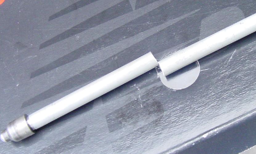

I had an in flight failure last week of N205AK's Suberu ea81. She was landed
with no problems and everyone is ok. The push rod on the # 4 cylinder (
Front right)snaped. Attached is a picture of the part . it made a clean
break almost dead center on the rod completely in to. With only 20 hrs on
the engine and only 5 in flight this should not have happened. Has anyone
else seen this before and why did it happen? P.S. it is a 100HP Stratus
conversion.

kirkhull(at)sbcglobal.net
PostPosted: Thu Jul 13, 2006 5:26 pm    Post subject: broken push rod suberu ea81 Reply with quote
sorry I must have forgotten to attach the photo so here it is
 Filesize:  56.59 KB
 Viewed:  429 Time(s)
wingsdown(at)comcast.net
PostPosted: Thu Jul 13, 2006 6:38 pm    Post subject: broken push rod suberu ea81 Reply with quote
Humm, that looks like an aluminum custom type. Is it? The stock ones, at
least on the turbo engine are steal, fat, real beefy. I don't have
experience with the non-turbo, maybe someone else can comment. I would
change to the tougher style, not good. Let me know.
Rick
janderson412(at)hotmail.c
PostPosted: Thu Jul 13, 2006 8:30 pm    Post subject: broken push rod suberu ea81 Reply with quote
Yes Rick, mine are are much thinker too and non turbo are the same. It  does look like an after market item. John A.

PostPosted: Fri Jul 14, 2006 4:25 am    Post subject: broken push rod suberu ea81 Reply with quote
These are not custom parts.  I got the replacement from the auto parts store.  it looks just like the one that broke.  however they are aluminum
PostPosted: Fri Jul 14, 2006 2:59 pm    Post subject: broken push rod suberu ea81 Reply with quote
thanks .  I am begining to think that NSI uses their own push rods and not the stock sub parts.
PostPosted: Fri Jul 14, 2006 7:03 pm    Post subject: broken push rod suberu ea81 Reply with quote
I installed the new pushrod today and checked the clearances on all valves. found two that were tight.  Still wandering if that could have caused the problem.  205AK run great again.  put .4 on her today with no problems but I think that I will pull all of the pushrods at the next inspection and inspect them just in case.

PostPosted: Sat Jul 15, 2006 3:26 am    Post subject: broken push rod suberu ea81 Reply with quote
Hello John. All the EA81 NSI normally aspirated engines have solid lifters
and the turbos have hydraulics. I don't know the reason for the difference.
Obviously the solids need to be adjusted properly, especially right at the
beginning and periodically thereafter. One of the most common reasons for
broken pushrods are incorrect adjustment which is an owner requirement.
Deke
