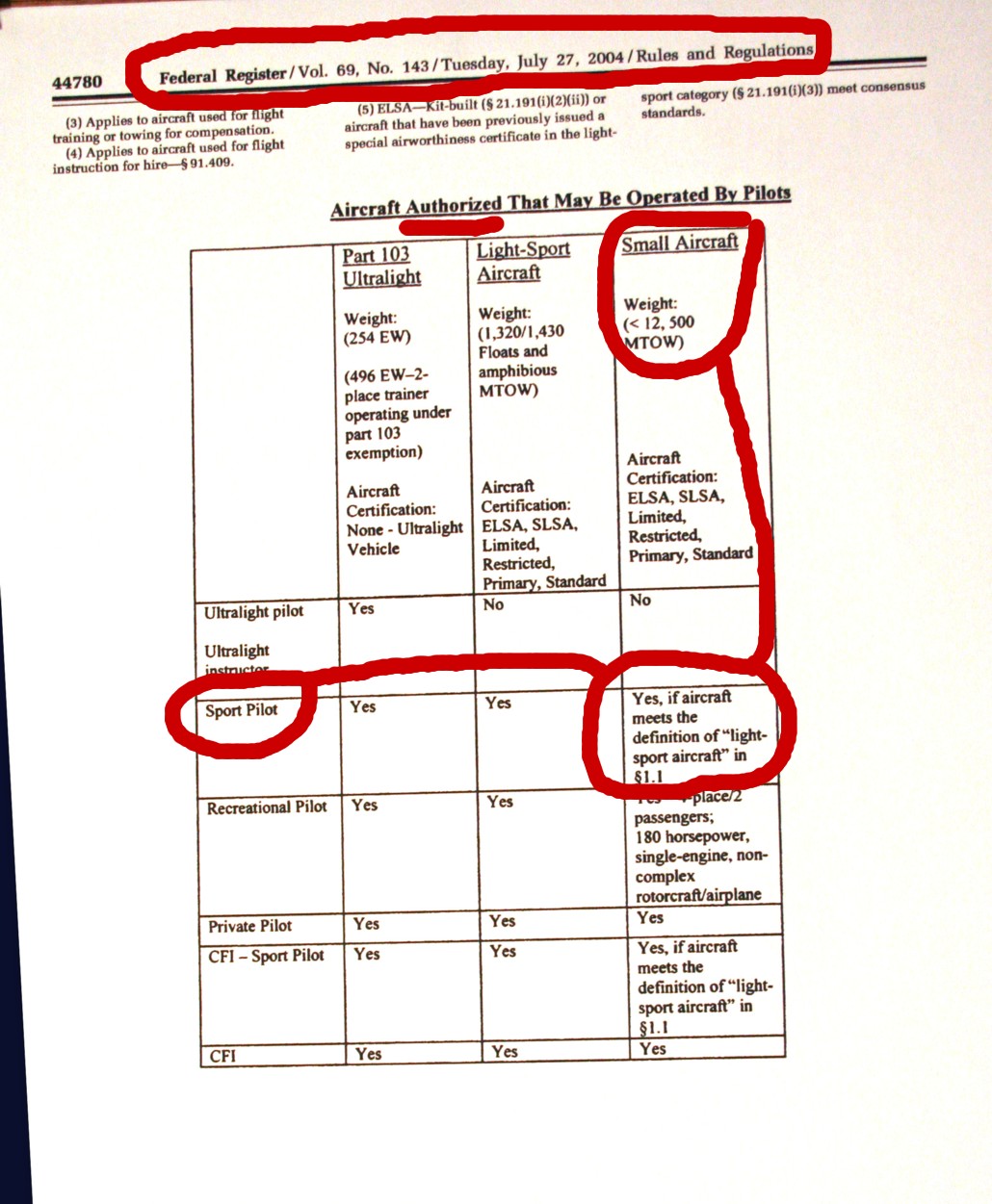

To all readers,
The attached FAA charts in .jpeg format, showing what aircraft sportpilots may operate under their .pilot pilot privileges is being provided here.
Please comment on accuracy and the ramification of this information in a professional manner, leaving out personal insults and childish taunts.
Do not break the thread. Post replies to this topic only, don’t start a new thread to express your view. This will avoid the clutter on the main page and keep the conversation very selectable and isolated. Don’t treat the board\list like a Instant Message service, reply at the last post in the original topic and maintain continuity.
Talk among yourselves, I will not get involved.
Steve

PostPosted: Fri Nov 10, 2006 8:47 am    Post subject: FAA aircraft chart for download Reply with quote
We don't have sport pilot here,
So, I have to ask what does 1.1 say?
Jan

PostPosted: Sat Nov 11, 2006 5:59 pm    Post subject: Re: FAA aircraft chart for download Reply with quote
(two days later...)
Jan,
There seems to be a lack of response to your question. This is due to the common and contagious infliction known as “Foot in Mouth “ disease, the result of which is extreme embarrassment, and the sudden urge to avoid further inflammation and discomfort from speaking out.
1.1, is FAR 1.1 which contains the FAA’s definitions as to be applied to specific word, of groups of words, to help clarify the content of a statement. They are non-negotiable.
In this case, the FAA (the chart) is allowing any Small aircraft, that is, any aircraft 12,500 lbs or less, to attempt to meet the definition of “light-sport aircraft” Maybe they will, maybe they won’t. (12,500lbs is the cutoff between Small aircraft and Large aircraft. You must apply the definition, and the weight determination formula that is applicable and found in another FAA regulatory document to see if your particular aircraft is eligible to be operated under sport pilot privileges.
The chart is showing that the potential, or certificated, maximum weight of the aircraft is not a disqualification, and confirms that the words “maximum takeoff weight”, as used in the 1.1 definition is the sum of conditions that include ….the empty weight of the aircraft, the weight of the total fuel capacity, and the weight of the pilot , and passenger if applicable, and whatever baggage you intend to carry in the aircraft. Nothing more, nothing less.
steve

PostPosted: Sun Nov 12, 2006 12:59 am    Post subject: FAA aircraft chart for download Reply with quote
Steve sez:
maximum takeoff weight, as used in the 1.1 definition is the sum of
conditions that include .the empty weight of the aircraft, the weight of the
Steve, you have repeatedly asked responders for references to the FARs in contesting your notions. I have wasted a considerable amount of my time trying to substantiate this nonsense. FAR 1.1 says, in part:
"Light-sport aircraft means an aircraft, other than a helicopter or powered-lift that, since its original certification, has continued to meet the following:
(1) A maximum takeoff weight of not more than-- ...
(ii) 1,320 pounds (600 kilograms) for aircraft not intended for operation on water;..."
Apparently, your confusion comes from the phrase "maximum takeoff weight." Your challenge is to produce the FAR that defines maximum takeoff weight. The previous references you have provided are NOT found in the FARs, they are part of the COMMENTARY the FAA provided in response to public COMMENT on the proposed light-sport ruling. Show us the FAR that DEFINES the phrase "maximum takeoff weight." I was unable to locate such a definition. There is a definition for "maximum certificated takeoff weight" in 14 CFR Ch. II, ss294.1, (f), but it does not support your claim: "Maximum certificated takeoff weight means the maximum takeoff weight authorized by the terms of the aircraft airworthiness certificate. This weight may be found in the airplane operating record or in the airplane flight manual that is incorporated by regulation into the airworthiness certificate."
I am not an attorney, nor do I play one on television, but I would not be surprised if you incurred some liability if someone acts on your interpretation of the light-sport regulations and is subsequently sanctioned by the FAA.
Geez, here I am ignoring my own advice to just let this topic die. :-p
Mike G.

PostPosted: Sun Nov 12, 2006 1:47 am    Post subject: Re: FAA aircraft chart for download Reply with quote
Federal Register Information
Federal Register: July 27, 2004 (Volume 69, Number 143)
Page 44771-44882
DEPARTMENT OF TRANSPORTATION
Federal Aviation Administration
14 CFR Parts 1, 21, 43, 45, 61, 65, and 91
[Docket No. FAA-2001-11133; Amendment No. 1-53, 21-85, 43-99, 45-24, 61-110,
65-45, 91-282
RIN 2120-AH19
Changes (start at 44791
Exact quote, pg.44793, cut and pasted here...
"Paragraph (1) Maximum Certificated
Takeoff Weight
Some commenters stated that lacking
a definition of maximum takeoff weight,
aircraft with fairly high performance
characteristics could meet the definition
of light-sport aircraft by limiting the
approved weight and payload of the
airplane. The FAA considers this a valid
concern and has provided some
additional constraints on the weight as
detailed below. The maximum weight of
a light-sport aircraft is the sum of:
(1) Aircraft empty weight;
(2) Weight of the passenger for each
seat installed;
(3) Baggage allowance for each
passenger; and
(4) Full fuel, including a minimum of
the half-hour fuel reserve required for
day visual flight rules in § 91.151(a)(1)"
+ chart (at) 44793
eskflyer(at)lvcisp.com
PostPosted: Sun Nov 12, 2006 6:15 am    Post subject: FAA aircraft chart for download Reply with quote
And what this means is if the aircraft has a certified max takeoff weight of
1320 for land plane or 1430 for a floats planethen it can be flown as a
E-LSA, S-LSA, This goes for certified aircraft as well if they meet the MAX
Takeoff weight as provided by the manufacturer. if it is 1325 for a land
plane , or 1435 for a seaplane ,pounds Certified on the certificate then it
will not be able to be flown as a LSA aircraft period .
This cannot be construed any other way period .

84KF
PostPosted: Sun Nov 12, 2006 7:18 am    Post subject: Re: FAA aircraft chart for download Reply with quote
In the original proposal:
Takeoff Weight”
Was changed to read
“maximum takeoff weight” in the final rule.
And you have been told why by the FAA.
Gentlemen, this post concerns the supporting chart. Do not avoid that issue

PostPosted: Mon Nov 13, 2006 8:36 am    Post subject: FAA aircraft chart for download Reply with quote
Steve sez:
Federal Register: July 27, 2004 (Volume 69, Number 143) Page 44771-44882...
The Federal Register is NOT the Code of Federal Regulations (CFR),
where the FARs live. Where is a definition of "maximum takeoff
weight" in the FARs?

84KF
PostPosted: Mon Nov 13, 2006 10:13 am    Post subject: Re: FAA aircraft chart for download Reply with quote
§ 21.190 Issue of a special airworthiness certificate for a light-sport category aircraft
Good,,,,, cept't that't has nothing to do with a Amateur-built airworthiness certificate issued under
21.191 Experimental certificates
g) Operating amateur-built aircraft. Operating an aircraft the major portion of which has been fabricated and assembled by persons who undertook the construction project solely for their own education or recreation.
We are not LSA compliant, just trying to meet the drfinition in 1.1
BIG big big difference. Don't mix the apples with the oranges.
http://forms.faa.gov/forms/faa8130-6d.pdf
Better look at this again..... And put your mark in the Amateur-built expeimental ( 2 ) box, not the Special Airworthiness ELSA or SLSA box.
"This passage refers to these old exceptions"
Kindly show yhat to me sir, please. Show me. Can't.
"With respect to defining “maximum takeoff weight,” I used the word “gross” "
Use ANY words YOU want, that will confuse others further.
"Since you are in a Detroit suburb, nobody on this list has supported you"
Excuse Me?? Care to expand on that statement?
Again....., What is the opinion of the chart?
BTW, this is a forum, not a "club". Sorry you don't approve of fact finding and discussion.
steve
