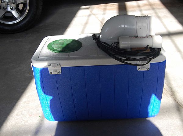

Has anyone heard of a successful installation of a portable air conditioner in an AA5? I use my plane to fly to business meetings but in the summer time the heat and humidity can be pretty brutal and flying in a suit is not really practical. I’ve made an portable air conditioner by converting an ice cooler (see attached) and it works okay for about an hour but after that the cockpit heats up quickly. Arctic Air (http://www.arcticaircooler.com/index.php?option=com_virtuemart&Itemid=80) offers real air conditioner that they claim is portable, has anyone heard of installing this system in an AA5 or other aircraft? They claim that the unit momentarily draws 40 amps at start up and 27 amps at high and 19 amps at low, can a standard AA5 electrical system handle this or would you have to upgrade the alternator? The exhaust would be routed through the rear bulkhead, can this be done without any major problems. The more I compare my Tiger to other aircraft the more I like it when you compare speed, reliability, simplicity (fixed gear/prop), and costs. The biggest gripe I have is the need for air conditioning during the summer to meet my business mission needs. Appreciate any insight that anyone may have.

Tom, where are you based? A couple of years ago it was really hot here in Auburn. I would climb above 7,000 feet to get to cooler air. One of my customers has a small cooler that plugs into a cigarette lighter. He puts it on the floor of the right seat and directs air with 3 inch SCAT to blow through the cooler to his side. It's crude but works.
The Grumman alternator is good for 60 amps. For the most part, you'll only use a fraction of that. So, the simple answer is, "The electrical capacity is there." The web site you provided says it needs 5 amps so I don't know where you got 27 amps. Your climb performance will be affected by the additional weight.

  Somehow the link I sent didn’t drill down to the Real A/C unit that actually uses a compressor and 134A refrigerant so I cut and pasted the unit I was talking about below. I think the unit you were looking at was the unit that uses ice like the one I built in the picture I sent with the original email. I live in the Norfolk Virginia area and the temps get to 100 degrees with 90% humidity and flying to a business meeting in business attire is almost impossible. The unit I currently have is like the one you described but it works okay for about an hour if you fill it with ice but I’m looking for a solution that is more effective and convenient like the RAC200-1-12D shown below

for $4,600, I'd go commercial. Seriously, for an AC that size, there is too much of a weight penalty. I'd find another solution.

Actually compared to A/C upgrades of other aircraft being $18,000 to $21,000 or buying a 2006 182 with A/C at around $250K I think $4,600 is a good deal (if the system works). Also a loaded ice chest cooler air conditioner weighs around 60 lbs. I’m trying to weigh options based on my business mission needs. If I can’t find a solution for my Tiger I may have to sell it and purchase another air craft with A/C
