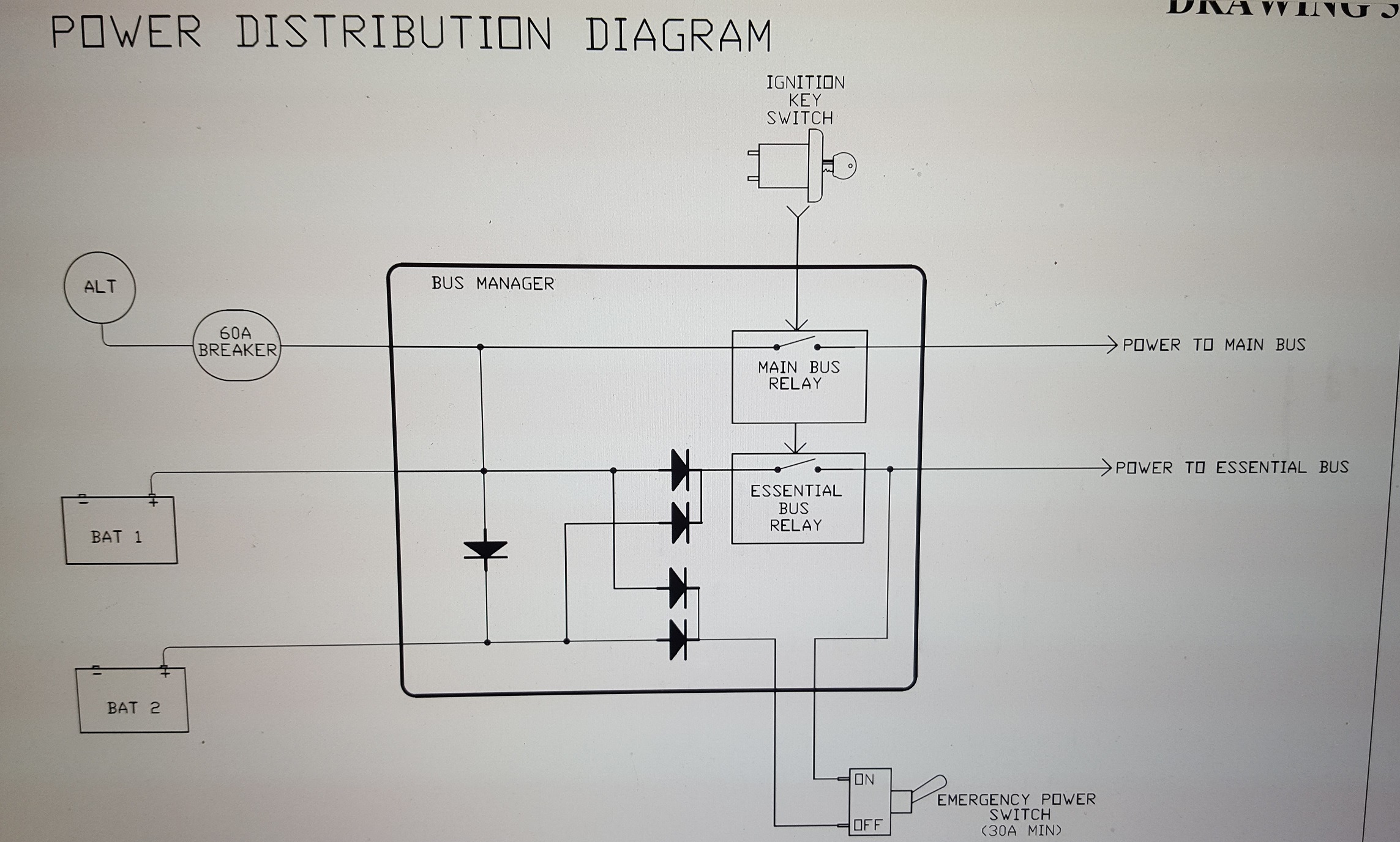

Getting ready to do the wiring this week with the above items and diagram. Slight fly in my ointment here, hence I'm looking for some guidance. I need to pick up power for the MANL30. Drawing has power source coming from Battery Contactor. I do not have such!! I am using the EFII Bus Manager which runs the Alt and batteries through two switched relays for powering my busses. The primary bus relay is rated up to 40A and the endurance bus relay for 30A. Thinking I need to tap into the power off the primary bus. Any agreement or disagreement regarding this? Attached is a pic of the power distribution from the Bus Manager.
Thanks for any insight Dave

In case of smoke in the cockpit or imminent forced landing, the pilot should
be able to shut off all power as close to the source (batteries) as possible.

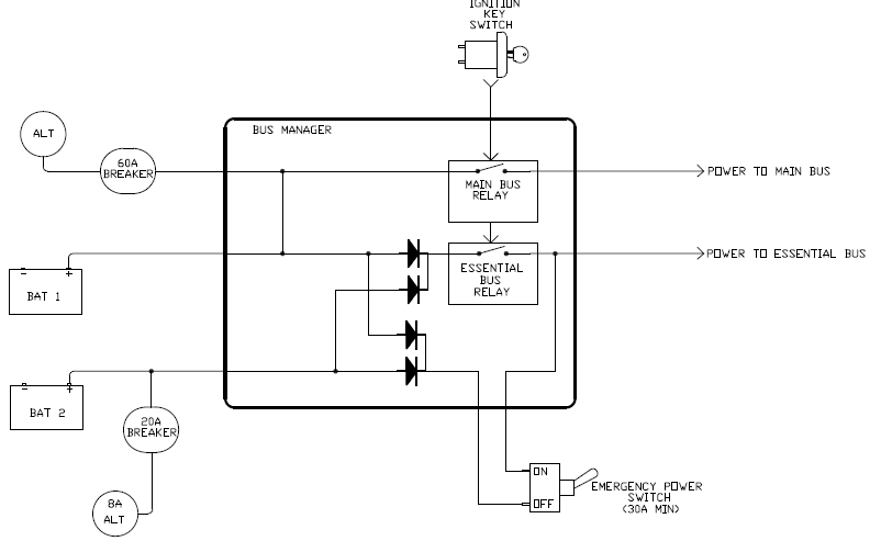

Dug up this drawing on the FFII bus manager
[img]cid:7.1.0.9.0.20180715213605.05951e50(at)aeroelectric.com.0[/img]
I'm mystified as to the rational for this architecture.
It has always hot b-leads to both alternators. With
this configuration, you could drive the MANL pump
limiter to the main bus . . . but I'm not sure the
relay inside the EFII is well suited to the
task. Alternatively, you could tie it to BATTERY(+)
and leave it hot all the time too.

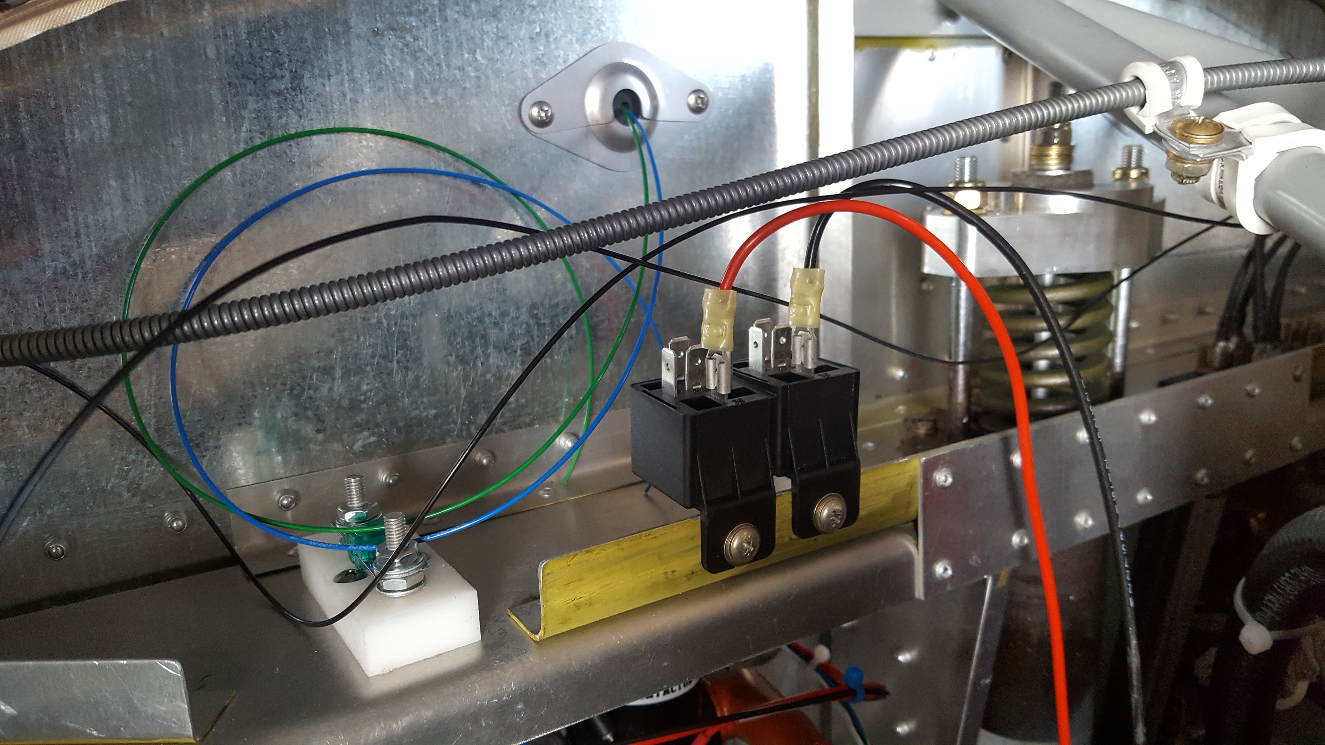

Thanks Bob, I get nervous when you get "mystified"... my setup is a dual battery, with single PMA alternator The alternator runs thru a 40A ANL then to a common terminal with Batt #1 to the Main bus relay, and the #2 battery runs to the Essential (endurance) bus relay. The EarthX batteries have onboard battery management (BMS) for battery "issues", and I have the B&C OVP module for the alternator, along with cockpit disconnect switch. I went with the EFII Bus Manager as a way to help with my system wiring during my design phase. Pros and Cons are always ready to be heard by me...only way I can consider improvements for the next time or as needed. I did go ahead and start wiring for the hydraulic pump with items from the "care" package you sent. Decided to tap power directly from the #1 battery, thru the MANL to the relays which are all located on the engine firewall forward. About a 8" run from the positive terminal to the MANL, and 6" run to the relays, and plenty of convenient grounding tabs! I've attached a pic for comments. Thanks for everyone's interest and insight...very much appreciated! Dave
I understand . . . and no doubt the EFII
gizmo performs as advertised. But you've already
experienced a design conundrum with where to tie
your hydraulic pump feeder to the system.
Products like the ECII, EXP-Bus, etc all perform
as advertised in the designer's airplane and
probably most of his/her customers. But the problem
you're wrestling wasn't conceived by the designer
of the whiz-bang-box . . . further, the design
chooses to march to the beat of a different drum
when it comes to FMEA and legacy design goals
for aircraft.

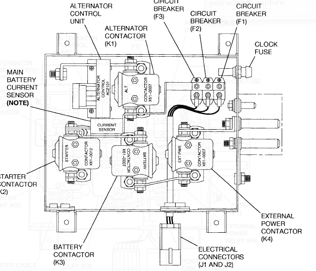

use a lot of common hardware. Cessna has their own
whiz-bang box
[img]cid:.0[/img]
Even includes the ground power connector!
The difference between this whiz-bang-box and
the EFII is that the box was designed to condense
about 80 years of lessons learned into a labor
saving product that didn't introduce new risks
or radically modify normal and abnormal operating
instructions.

Having said all that, I'll suggest you locate your
MANL as close as practical to the EFII battery(+)
terminal and tie it in there. This will FUNCTION
but it's a really scuzzy band-aid.
  instructions.
  One would hope that producers of EXB-Bus, EFII
  et. als. had some philosophy founded in good
  FMEA outcomes while maximizing flexibility of
  application for the greatest number of builders.
  Sadly, I'm seeing little, if any, consideration
  for such matters in these products.
  This is why I am reluctant to suggest work-arounds
  for problem like yours. Offering a personal band-aid
  on a poorly designed accessory might easily be
  mis-interpreted as some kind of agreement with
  the design of the product. Suffice it to say that
  there are good reasons why I would not be able to
  qualify those products onto a TC aircraft under
  the rules in place when I was last involved in
  such things.

Nothing lasts forever, including the newfangled electronic bus managers.  When something goes wrong, the whole box must be sent back to the manufacturer for repair, if they are still in business.  Compare that to conventional wiring when a fuse blows.  Yes, electrical knowledge is required to figure out why the fuse blew.  But the aircraft is still flyable without that one circuit, which any mechanic can troubleshoot.  Fuses are just as easy to install as the electronic box and cost a whole lot less.
  Being able to view the current draw of each circuit on the EFIS screen is a nice feature.  But wouldn't it be better to be looking out the windows and to do troubleshooting when on the ground?

There was a long discussion on this list about multiple single points of failure in the Bus Manager device, and there have been several threads on the VAF forum discussing multiple single points of failure in the device. Here's one:
http://www.vansairforce.com/community/showthread.php?t=146753&highlight=bus+manager
Unfortunately, the VAF forum owner considers his profit margin more important than the service his members supply (for free), so all the images have disappeared. But you should be able to get some idea from just the text in that thread. The response of Robert Paisley (face of Bus Manager's parent company) is that 'there have been no failures so far, so move along; nothing to see here'.
You can kludge stuff around it to make the total a/c system somewhat less vulnerable to single failures in the Bus Manager taking down the whole system, but why pay the big bucks, only to have to do that?
