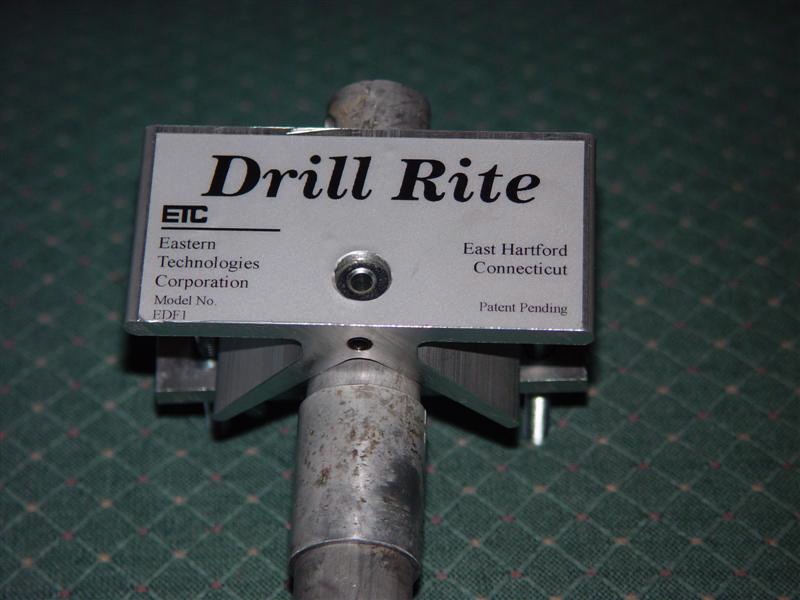

Carolina Flyer
Joined: 03 Oct 2010 Posts: 62 Location: Buffalo, South Carolina
Posted: Thu Jul 11, 2013 1:12 pm Post subject: Re: Drilling Center Of Tube |
Here is what I use and it works perfect every time

Dnul
Joined: 09 Feb 2013 Posts: 18 Location: O'Fallon, IL
Posted: Fri Jul 12, 2013 10:22 am Post subject: Re: Drilling Center Of Tube |
That would be great to order for drilling the vertical stabilizer post, the drag strut, or the landing gear leg and the universal joint on the aileron control tube which would be drilled inaccurately. It might be used to drill an innumerable number of holes in small tubing used in the wing.
