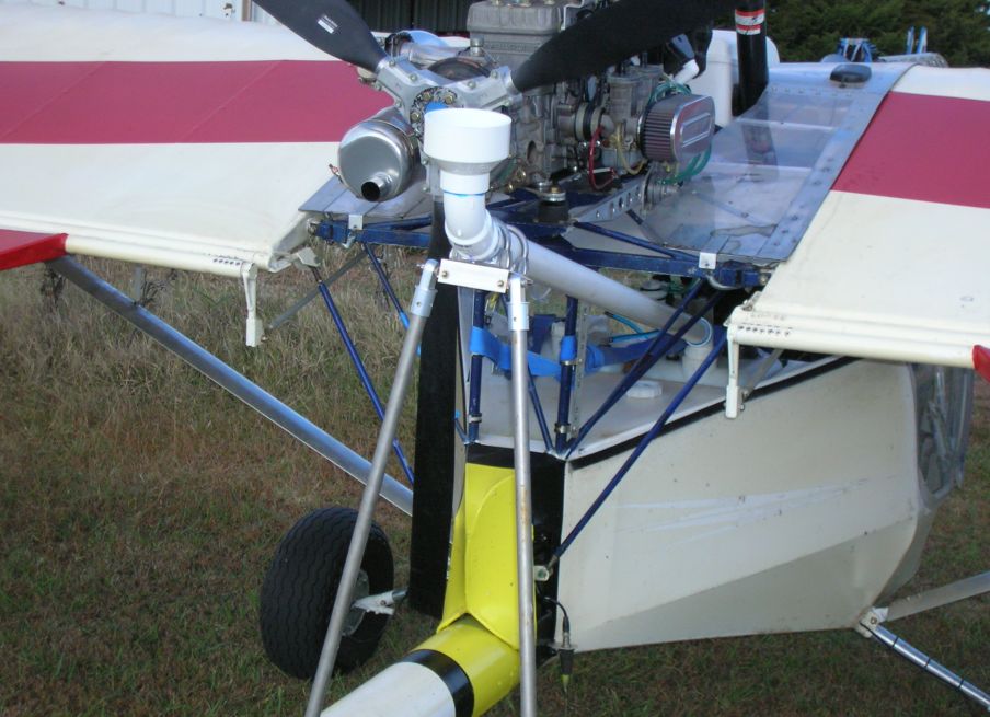

PostPosted: Thu Jul 12, 2012 11:51 am    Post subject: grounding procedures Reply with quote
Bob, I built this rig to fuel my little LSA. I built it mainly to get out of having to bend over and crawl under the wing to fuel, but it also gets me away from where the fuel is flowing. The tubing legs (titanium from Boeing Surplus!) provide grounding although I am going to take advantage of the advice offered here and install a copper wire to pick up any static from fuel flowing through the plastic pipe and run it out to the legs to ground that, too. Using stuff from my strategic supplies and plastic pipe and fittings from Lowe's the whole thing cost less than $10. The other precaution I use during fueling is to always have a size 20 fire extinguisher rated for flammable liquids right next to me.
Rick Girard
On Thu, Jul 12, 2012 at 11:05 AM, Robert L. Nuckolls, III <nuckolls.bob(at)aeroelectric.com (nuckolls.bob(at)aeroelectric.com)> wrote:

  Sure, while funnels provide a handy tool for control
  of the flow of liquid, they add a piece of 'loose gear'
  to the mix and expose a the surface of liquid flow
  to the air (and funnel surface). The former increases
  local concentration of hazardous vapor, the later increases
  potential for building an electro-static charge (motion
  of dissimilar materials in close proximity). Your body
  became yet another surface on which generated charges
  could collect. A hair-raising experience both literally
  and for consideration of increased risk.
  99.999+ of fuel transfers in the world are effected with
  a nozzle extend into the fuel storage system. Most are
  metallic and in contact with each other. The only
  thing you can do to IMPROVE on this combination would
  be to close the liquid motion off from the air and
  potential for spillage by using some feature like I
  suggested yesterday.
  As a general rule, I would avoid the use of funnels.
  Yeah, Lindbergh used 'em . . . even lined the funnel
  with a chamois to absorb water. We don't read much
  about aviators of yor setting themselves on fire
  during a fueling accident but the risks were demonstrably
  great.
