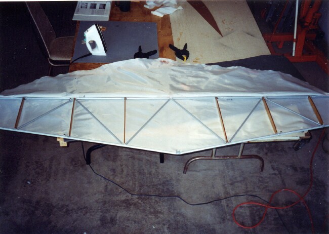

Jim, my classic 4 kit came with wood ribs for the horizontal stab only. I asked the old Skystar factory why not the elevator too and he said it would not matter, that it was mostly just for looks. Being anxious to finish I built it with the ribs just in the horizontal.
I haven't flown one with the elevator or vertical and rudder air foiled so I can't comment on their being any difference. Mine does fly straight and smooth.
I seem to remember some chat that if installed by the book the ribs in the horizontal don't line up with those in the horizontal and that makes it look funny. You might check that and line them up if you decide to put ribs in the elevator too.

I got to thinking more about this so went out and looked. My horizontal has only six wood ribs. They are each positioned with one end in the V formed by the 4130 tubing braces. This placement does not match any of the ribs shown in the speedster airfoil tail instructions. I think their primary purpose is to brace the opposite leading/trailing edge to prevent it from bending when the cover is shrunk.
Here's my builder's documentation book photo.

Subject: RE: Re: wood ribs on tailfeathers on a Kitfox 4
Actually Kitfox uses 3mm 5 ply aircraft birch plywood. .118 inch thick.
Clint
[quote] From: lcfitt(at)sbcglobal.net (lcfitt(at)sbcglobal.net)
To: kitfox-list(at)matronics.com (kitfox-list(at)matronics.com)
Subject: Re: Re: wood ribs on tailfeathers on a Kitfox 4
Date: Fri, 11 Jun 2010 11:04:48 -0700
--> Kitfox-List message posted by: "Lowell Fitt" <lcfitt(at)sbcglobal.net (lcfitt(at)sbcglobal.net)>
Being experimental, I suppose you could use about anything. I used 1/4"
urathane foam with light weight glass laminated on each side. I think the
factory uses birch plywood 1/4" thick. I doubt the airfoil is critical,
meaning engineered. I think what I would use in similar circumstances is
1/8" plywood with a half inch stiffener hysoled to the side, making a "T"
with the top of the tee being the rib. Use a fillet on the hysol.
If you want to send your address - off list, direct - I have a partial set
of ribs you can have for postage.
Lowell
From: "egp8111" <egp8111(at)aol.com>
Sent: Friday, June 11, 2010 4:46 AM
To: <kitfox-list(at)matronics.com>
Subject: Re: wood ribs on tailfeathers on a Kitfox 4
> --> Kitfox-List message posted by: "egp8111" <egp8111(at)aol.com>
> the KFIII manual calls for wood stiffeners in the HS but they are not
> airfoil shape. Does anyone have the template for the airfoil ribs on the
> HS and elevator that they could post ? What material is used to make
> them, the plans are not specific on this. thanks
> http://forums.matronics.com/viewtopic.php?p=300923#300923
