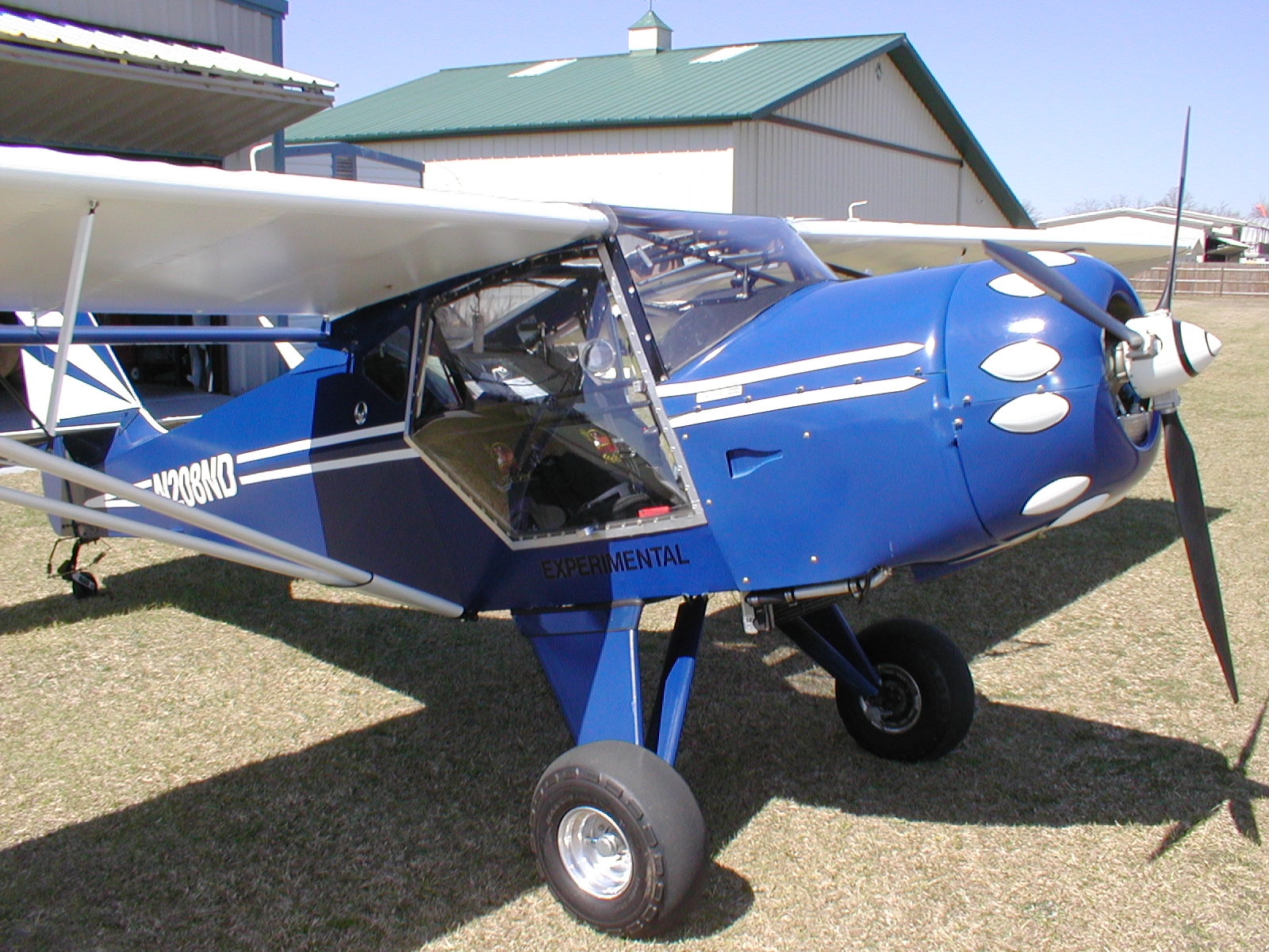

Where can you get King Fox tires.I keep reading about them and I am looking for a set of Tundra tires to replace my original shaved ATV tires which are on my original chrome wheels.I think the size of my tires is 20 x 8 x7 and the wheels are one piece. Any ideas would sure be appreciated !
Dick Maddux
Fox 4-1200
Pensacola,Fl

dave
Joined: 22 Sep 2006 Posts: 1382
Posted: Sun Mar 23, 2008 5:36 am Post subject: Re: King Fox Tires |
I got a truck load of them from Kevin at Mippi.
All sold out now for 40$ each.
Awesome tires. http://www.cfisher.com/kingfox.html

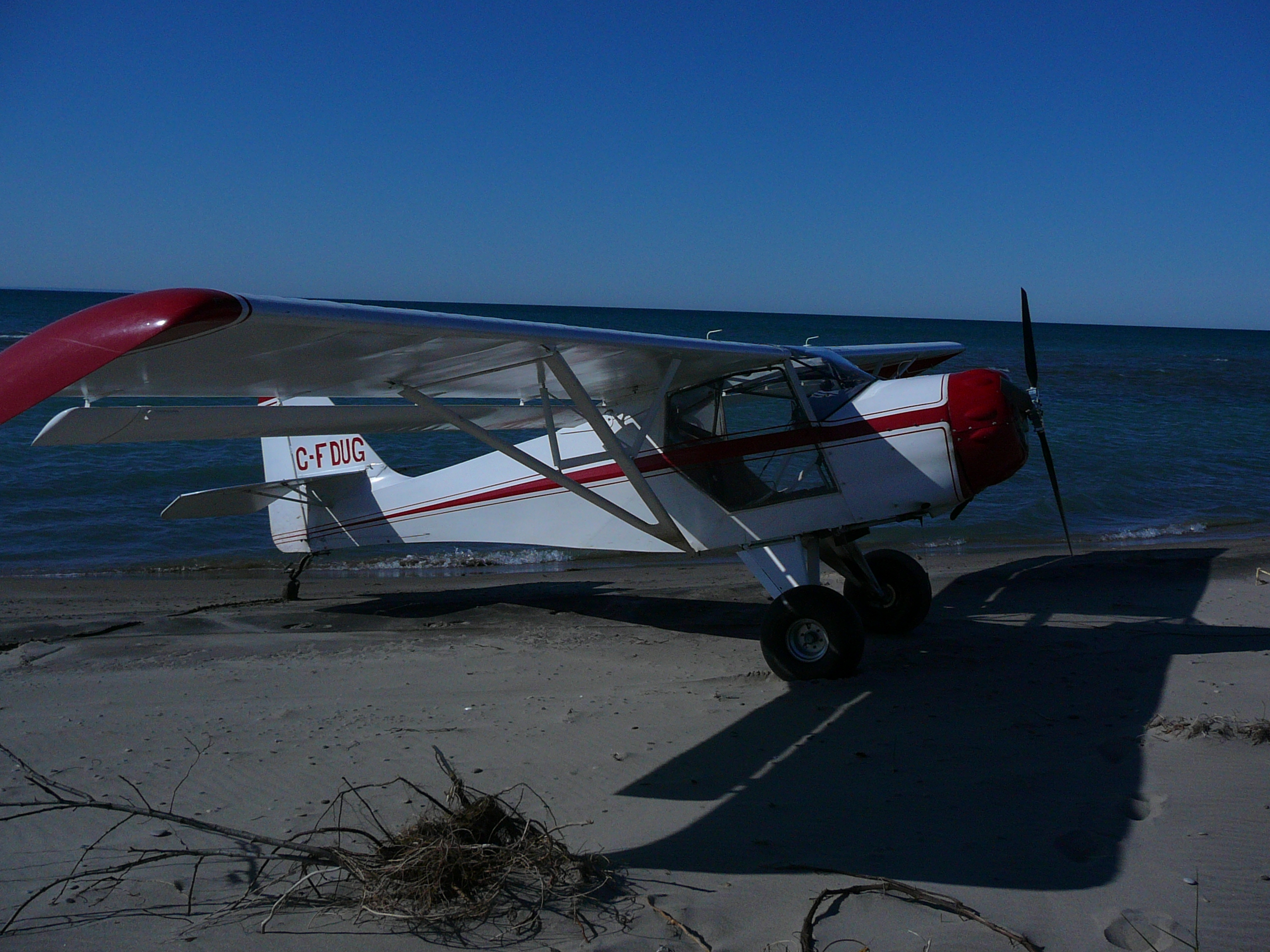

dave
Posted: Sun Mar 23, 2008 5:41 am Post subject: Re: King Fox Tires |
Tires leave virtually no foot print on the beach.
This pic is taken 23 miles off the mainland in Lake Erie at tip of Long Point .

dave
Posted: Sun Mar 23, 2008 5:43 am Post subject: Re: King Fox Tires |
to show you how far out on Lake Erie we were look in background
<snicker>
Pics taken by Gary Walsh from his Kitfox Amphib
