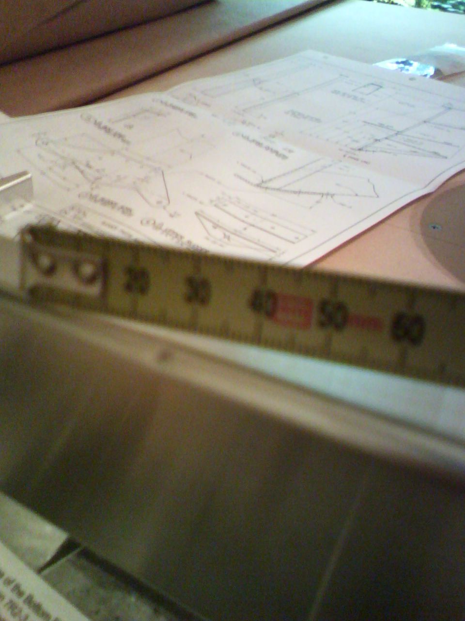

Grrrr....mad at myself for either (1) not noticing this upon shipment OR (2) causing it myself somehow, unknowingly.
I plan on contacting ZAC tomorrow to show them the pictures. It is a smooth dent, about 4mm in width. I don't like where it is (~220mm from top of spar). What is your take?
Tom

according to your post it is a "smooth dent". I take this to mean that it does not have either a mark at the bottom of the impression or sharp departures at the limits of the depression. If that is so, as I recal, this is under the footprint of the spar flange angle doubler. It might be possible to bump it back to contour without cracking or tearing the material using a stick made from maple with a relatively small radius on the end and a block of pine on the outside as an anvil. This would allow the doubler to lie shear on the inner surface of the flange as designed.
Ideally, the hole pattern will straddle this defect. Being so near the tip, is does not see a lot of bending and may not be a critical issue. ZAC will know. Just be cautious if it is near and beyond the end of the doubler. If something were to happen you would not be able to inspect for it...

Aluminum is relatively cheap and it looks like you haven't done much work on it. It's probably inconsequential, but why start your build with a main structural part that is defective. I would just get a new one. The old spar will make a great doubler down the road when installing antennas, ELT's etc. so it won't go to waste.

Thanks for the advice. The dent is 220mm from the top of the spar, so there is no doubler there. Depending on what the engineers at ZAC say, I may just get a new one as Steve suggested. I'll make sure to post with ZAC's response.

if this is the main rudder spar, its kind of hazzy, just build it it does not look bad, the rudder is so over built a ding is nominal.

A preliminary response from a Zenith engineer indicated that you are probably right. I was told that unless it is a deep scratch or it busts through the material, it is most likely OK. Being the anal engineer that I am, I sent photos over for a more thorough evaluation. I should be hearing back by close-of-business today.

Tom, if you decide that you need to press out the dent, you can take two pieces of 1/8" extruded aluminum el cheapo angle from Lowes or Home Depot, round the exterior corner of one of them. The round edge must fit the bend radius of the spar. Use the rounded piece on the inside and the unaltered piece on the outside and squeeze the spar between the two with a vise or clamps to press out the dent. Pressing dents out with an appropriate set of dies is always easier than spooning or hammering.

I just received a response from a ZAC engineer that looked at the photos. He said that the dent is not a big deal, but if I am concerned about it, I can install another doubler in that area. Of course, these are recommendations, and each situation is unique. If you encounter a similar situation, you are best off seeking advice specific to your situation. The following disclaimer at the end of the ZAC e-mail I received illustrates this pretty well:
"Technical Support Disclaimer: While we strive to ensure that the advice/information provided through our support is correct, Zenith Aircraft Company does not accept any responsibility for errors or omissions. Any advise or information that Zenith Aircraft Company gives you via any form of communication is not a guarantee that it will correct your problem. It is only offered as assistance to you. Zenith Aircraft Company will not be held responsible for any loss or damage as a result of our advise or information supplied. "
As always, take advice with a grain of salt, no matter what source it is from. I also learned that ZAC does NOT recommend using a 1/2" drill bit to debur holes, as is presented in the metalworking 101 DVD.
I plan to continue construction as-is. Adding a doubler in that location would mean popping the dent out, which I am not sure I can do without causing additional damage.
