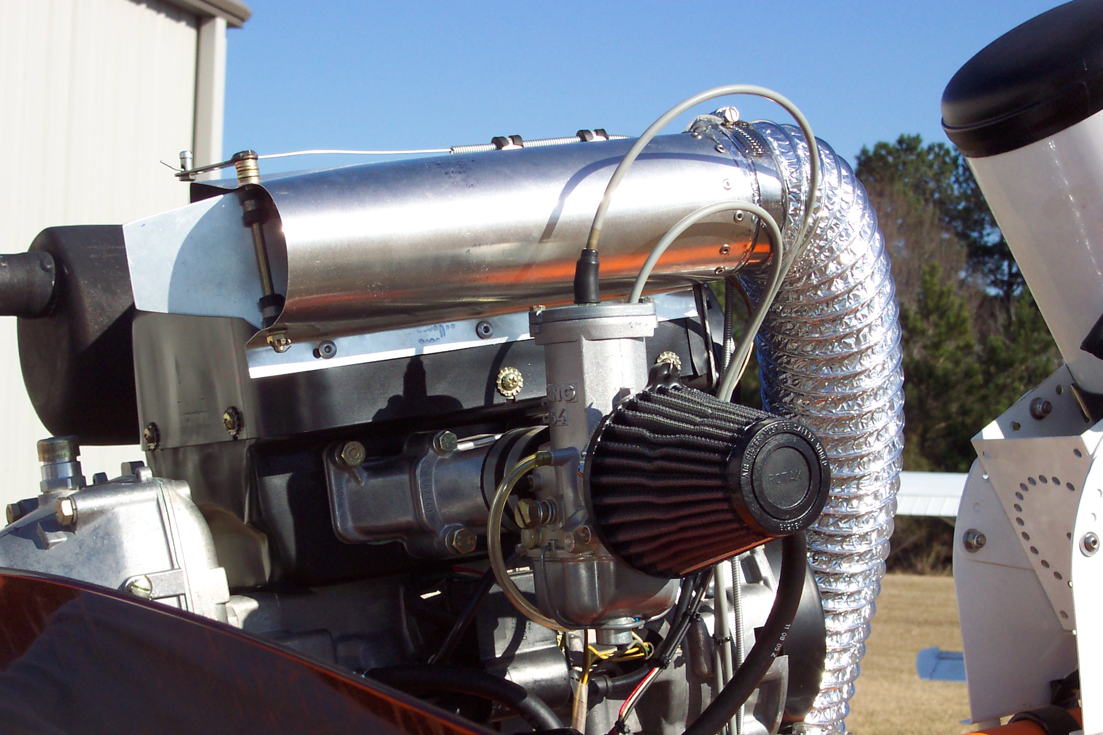

Looked at you photo - looks like you have your carb titled forward -
that would make it even worst when the tail is in flying position -
correct that, make it level with the engine (tail) in normal flying attitude.
Looks like you have the little loop of tubing which connects between
the two small barb fittings located on each side of the carb, is
there a hole in the center of it for venting.?

Looking closely at your photo, there is a stain on you throttle cable
where it enters the top of the carb - has it changed position at all,
it looks as if has at some time. That may be from adjusting the
cable over time. Make sure the carb slide is fully opening and
fully closing as explained in the above step.

So my Rotax 447 Bing 54 carb Firestar has been at another airport
for 2 days now... the reason...
When I apply full power and take off about 30 seconds into the climb
I loose engine power. I can run at partial throttle and get back
and land, but the full throttle will kill it.
I have a couple theories...
One is a bad/wrong size main jet...
but I took it apart and verified it was clean and the right size
(it's a 165) and today it was an internationally standard day temp
wise (65F) at sea level.
My other thought is maybe the carb is not vertical and tilted too
far back during the climb and therefore the bowl level is tilted and
uncovering the jet?
I'll attach a picture of the carb...
Any other thoughts on what it may be...
Ground run is good, I adjusted the clip to #2 from top and re tuned
the carb on the ground.
-Erik
